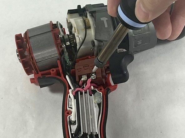

  4. Milwaukee 2704-20 Trigger Replacement, Trigger: crwdns2935265:04crwdnd2935265:01crwdnd2935265:02crwdne2935265:0 Milwaukee 2704-20 Trigger Replacement, Trigger: crwdns2935265:04crwdnd2935265:02crwdnd2935265:02crwdne2935265:0
    • Desolder the two solder joints on the trigger assembly.
    • USE CAUTION! Soldering irons get extremely hot, as will everything they make prolonged contact with.

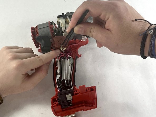

  5. Milwaukee 2704-20 Trigger Replacement: crwdns2935265:05crwdnd2935265:01crwdnd2935265:02crwdne2935265:0 Milwaukee 2704-20 Trigger Replacement: crwdns2935265:05crwdnd2935265:02crwdnd2935265:02crwdne2935265:0
    • Using tweezers, remove the header connector.
    • To avoid damage, be careful replicating this step in both the removal and replacement processes.
  6. Milwaukee 2704-20 Trigger Replacement: crwdns2935265:06crwdnd2935265:01crwdnd2935265:01crwdne2935265:0
    • Remove the trigger mechanism entirely.
