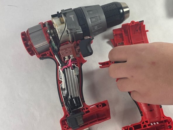

    • Remove the indicated screws (M3 x 16mm Pan Hd. ST T-10 Screws) with screwdriver.
  3. Milwaukee 2704-20 Control Switch Replacement: crwdns2935265:03crwdnd2935265:01crwdnd2935265:03crwdne2935265:0 Milwaukee 2704-20 Control Switch Replacement: crwdns2935265:03crwdnd2935265:02crwdnd2935265:03crwdne2935265:0 Milwaukee 2704-20 Control Switch Replacement: crwdns2935265:03crwdnd2935265:03crwdnd2935265:03crwdne2935265:0
    • Gently lift the cover off the drill. Be careful not to force it or damage any of the internal components.
    • If the cover doesn't come off easily, check for any clips or latches that may be holding it in place. These can usually be released by pressing them with a small flathead screwdriver.

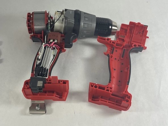

  4. Milwaukee 2704-20 Control Switch Replacement, Control Switch: crwdns2935265:04crwdnd2935265:01crwdnd2935265:03crwdne2935265:0 Milwaukee 2704-20 Control Switch Replacement, Control Switch: crwdns2935265:04crwdnd2935265:02crwdnd2935265:03crwdne2935265:0 Milwaukee 2704-20 Control Switch Replacement, Control Switch: crwdns2935265:04crwdnd2935265:03crwdnd2935265:03crwdne2935265:0
    • Remove the control switch.
    • It is not attached to anything and should slide out easily. Take note of orientation and be sure to replace it in the same position.
