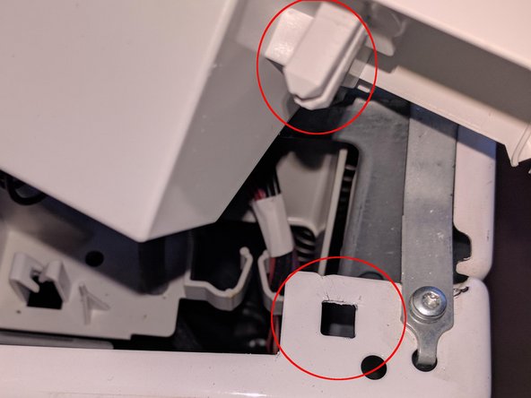

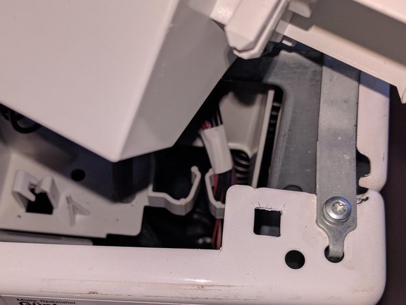

  9. Miele W4164 disassembly: crwdns2935265:010crwdnd2935265:01crwdnd2935265:02crwdne2935265:0 Miele W4164 disassembly: crwdns2935265:010crwdnd2935265:02crwdnd2935265:02crwdne2935265:0
    • The control unit is hooked into two places, one to the right of the detergent drawer and one to the far right.
    • Carefully loosen the unit there, it is still connected with cables, so place the unit carefully on the machine.

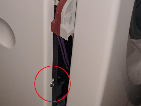

  10. Miele W4164 disassembly: crwdns2935265:011crwdnd2935265:01crwdnd2935265:02crwdne2935265:0 Miele W4164 disassembly: crwdns2935265:011crwdnd2935265:02crwdnd2935265:02crwdne2935265:0
    • The front is still attached with two Tx20 screws on the right and left, loosen them while holding the front so that it doesn't accidentally fall down and get damaged. The front has a small hold on the right screw through the metal bracket.

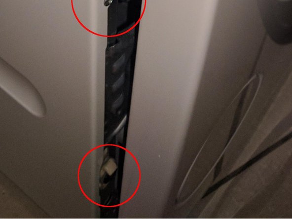

  11. Miele W4164 disassembly: crwdns2935265:012crwdnd2935265:01crwdnd2935265:01crwdne2935265:0
    • The front front is hooked to small feet, lift slightly to release. Make sure that the damper rubber remains on the feet. The front is still connected to the machine via the rubber boot. Keep holding the front.
  12. Miele W4164 disassembly: crwdns2935265:013crwdnd2935265:01crwdnd2935265:03crwdne2935265:0 Miele W4164 disassembly: crwdns2935265:013crwdnd2935265:02crwdnd2935265:03crwdne2935265:0 Miele W4164 disassembly: crwdns2935265:013crwdnd2935265:03crwdnd2935265:03crwdne2935265:0
    • Now move the front a bit so that you can loosen the 3 Tx20 screws on the left front. Then reinsert the front panel and fix it with the two upper screws. The left front can now be removed. Attention when installing the left front later, it will be hooked in at the lower end.
