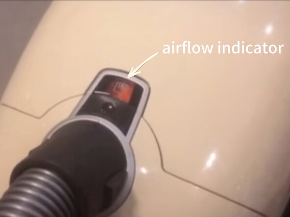

  1. Miele Vacuum Repair vacuum bag Replacement, Watch the airflow indicator: crwdns2935265:01crwdnd2935265:01crwdnd2935265:01crwdne2935265:0
    • When the airflow indicator turns red, it means your hoover bag is full and needs changing. Waiting too long can reduce suction power.

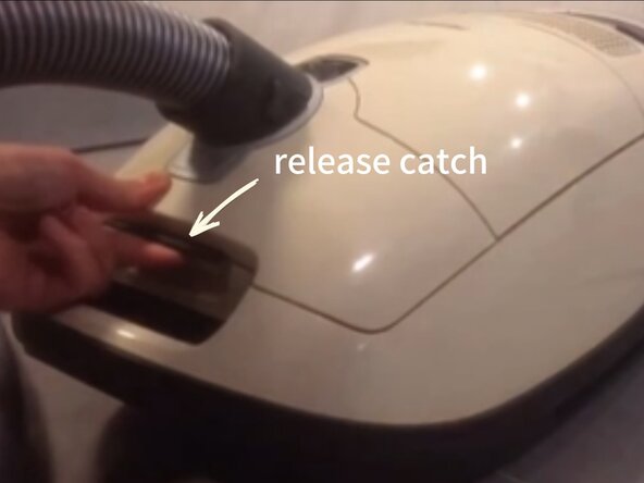

  2. Miele Vacuum Repair vacuum bag Replacement, Open the dust compartment lid: crwdns2935265:02crwdnd2935265:01crwdnd2935265:01crwdne2935265:0
    • Press the release catch near the handle to pop open the lid. For better access, you can detach the suction hose before opening.

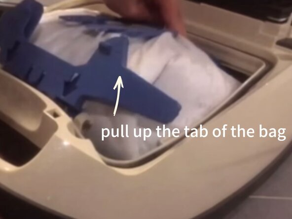

  3. Miele Vacuum Repair vacuum bag Replacement, Remove the old bag: crwdns2935265:03crwdnd2935265:01crwdnd2935265:01crwdne2935265:0
    • Pull up on the small blue plastic tab to release the full bag from the holder. Don’t worry — Miele GN bags automatically seal when removed, keeping dust inside.

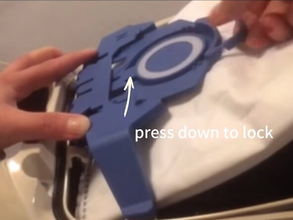

  4. Miele Vacuum Repair vacuum bag Replacement, Insert a new GN hoover bag: crwdns2935265:04crwdnd2935265:01crwdnd2935265:01crwdne2935265:0
    • Take your new Miele GN bag, line up the arrows with the holder, and press down until you hear a secure click. 👉 Make sure the bag is fully clicked into place — if not, the opening may not align properly with the hose, causing dust to leak outside the bag during use.
