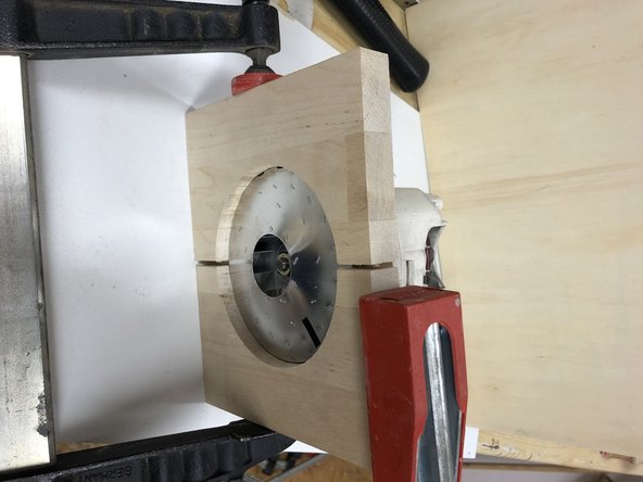

  10. Miele S828 Vacuum cleaner Disassembly, Remove fan blade: crwdns2935265:010crwdnd2935265:01crwdnd2935265:03crwdne2935265:0 Miele S828 Vacuum cleaner Disassembly, Remove fan blade: crwdns2935265:010crwdnd2935265:02crwdnd2935265:03crwdne2935265:0 Miele S828 Vacuum cleaner Disassembly, Remove fan blade: crwdns2935265:010crwdnd2935265:03crwdnd2935265:03crwdne2935265:0
    • I used pieces of wood to hold the fairly light and delicate aluminium fan while opening the nut in the center holding it to the drive shaft.
    • Use a 13mm hex wrench to open the nut. Of note: Its a left thread, so opens clockwise!

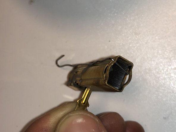

  13. Miele S828 Vacuum cleaner Disassembly, Reassembly: crwdns2935265:013crwdnd2935265:01crwdnd2935265:03crwdne2935265:0 Miele S828 Vacuum cleaner Disassembly, Reassembly: crwdns2935265:013crwdnd2935265:02crwdnd2935265:03crwdne2935265:0 Miele S828 Vacuum cleaner Disassembly, Reassembly: crwdns2935265:013crwdnd2935265:03crwdnd2935265:03crwdne2935265:0
    • When reassembling, a paper clip is a useful tool to hold the brushes back in their housing until the rotor is in place
