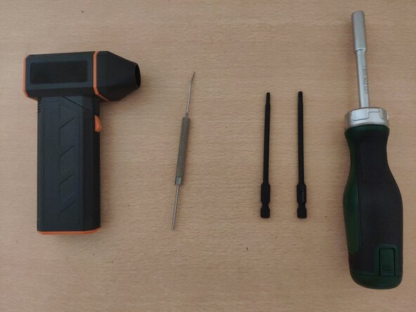

  1. Miele CM7 Coffee Maker - brew unit refresh, Details about tools: crwdns2935265:01crwdnd2935265:01crwdnd2935265:01crwdne2935265:0
    • T15 bit must be at least 1.7 inch (4.4 cm) long, and at most 0.3 inch (0.75 cm) thick. T10 bit can be any size.
    • Blower and sharpy (on left) are must-have for cleaning the filters.

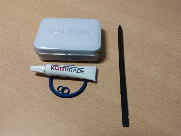

  2. Miele CM7 Coffee Maker - brew unit refresh, O-Ring kit: crwdns2935265:02crwdnd2935265:01crwdnd2935265:01crwdne2935265:0
    • This is the kit I used. It comes with 3 O-Rings, and some grease.
    • Note: the sharp plastic tool is not provided with the kit, I used it to remove old O-Rings.
