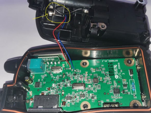

    • BE CAREFUL - there is a pair of wires going to what looks like a small motor and some kind of spinning item
  4. Midland GXT10x0VP4 GMRS radio Disassembly: crwdns2935265:04crwdnd2935265:01crwdnd2935265:02crwdne2935265:0 Midland GXT10x0VP4 GMRS radio Disassembly: crwdns2935265:04crwdnd2935265:02crwdnd2935265:02crwdne2935265:0
    • This is as far as I've gotten, as I want to research some more, and wait until I get a closer look at the radio in my workshop
    • - where are better antenna and other components sourced?
    • -how does one account for the water resistant seals when further dissassembling (seals around the On-Off/Volume knob, PTT switch and headphone/mic connectors)
    • -what is the spinning item/motor for? tone generation? some kind of EM field? (motor marked with yellow circle in 2nd pic)
