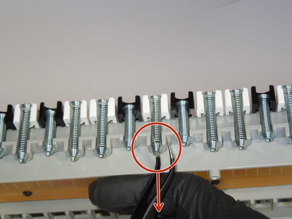

  5. Midiman Oxygen 8 Keys Replacement, Keys: crwdns2935265:05crwdnd2935265:01crwdnd2935265:01crwdne2935265:0
    • The keys are retained via a tension spring. The removal of these springs is simple using the hooked needle point tweezers from the IFixit Toolkit.
  6. Midiman Oxygen 8 Keys Replacement: crwdns2935265:06crwdnd2935265:01crwdnd2935265:02crwdne2935265:0 Midiman Oxygen 8 Keys Replacement: crwdns2935265:06crwdnd2935265:02crwdnd2935265:02crwdne2935265:0
    • To remove, simply insert one of the tweezer ends through the opening at the end of the spring.
    • Press the end between the spring windings after the windings start to reduce in size towards the inside of the spring.
  7. Midiman Oxygen 8 Keys Replacement: crwdns2935265:07crwdnd2935265:01crwdnd2935265:01crwdne2935265:0
    • Next, clasp the spring windings with the tweezers and gently apply tension outward.
    • The spring should thin slightly and be easily raised up and out of the retaining keyway.
    • This will free the key from the keyboard assembly for repair or replacement.
