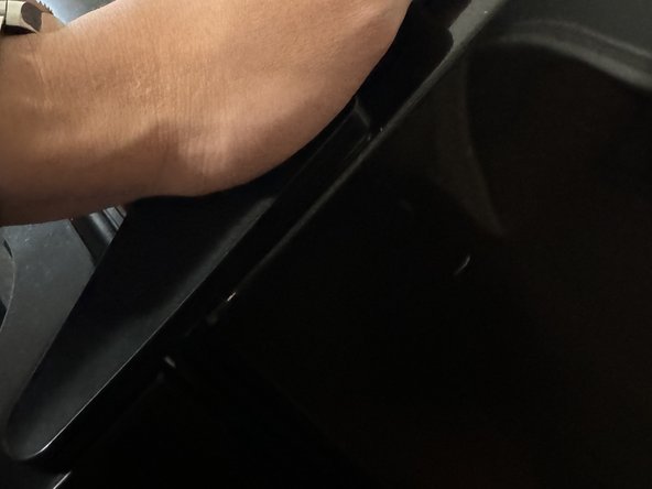

  3. Midea MRU03M2ABB Upright Freezer Door Replacement: crwdns2935265:03crwdnd2935265:01crwdnd2935265:03crwdne2935265:0 Midea MRU03M2ABB Upright Freezer Door Replacement: crwdns2935265:03crwdnd2935265:02crwdnd2935265:03crwdne2935265:0 Midea MRU03M2ABB Upright Freezer Door Replacement: crwdns2935265:03crwdnd2935265:03crwdnd2935265:03crwdne2935265:0

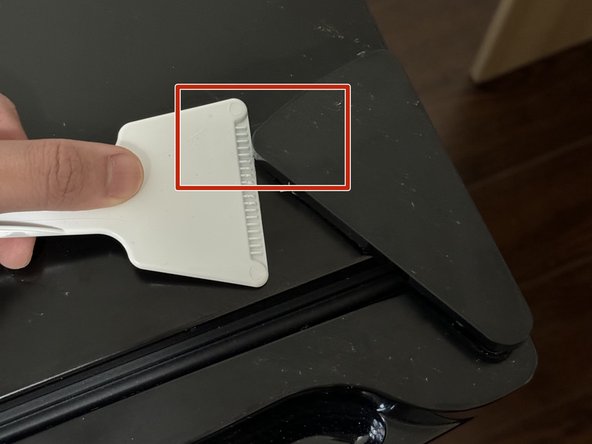

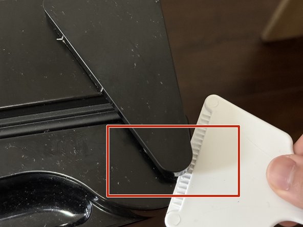

    • Use a plastic spatula to remove the hinge cover on top of the freezer.
    • Pushing at the pointy part of the cover makes it easier to remove.

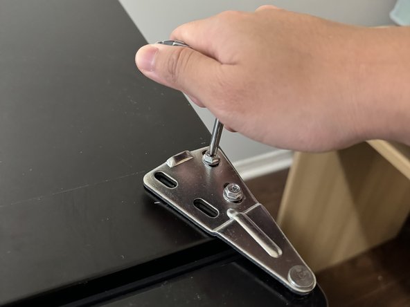

  4. Midea MRU03M2ABB Upright Freezer Door Replacement: crwdns2935265:04crwdnd2935265:01crwdnd2935265:03crwdne2935265:0 Midea MRU03M2ABB Upright Freezer Door Replacement: crwdns2935265:04crwdnd2935265:02crwdnd2935265:03crwdne2935265:0 Midea MRU03M2ABB Upright Freezer Door Replacement: crwdns2935265:04crwdnd2935265:03crwdnd2935265:03crwdne2935265:0

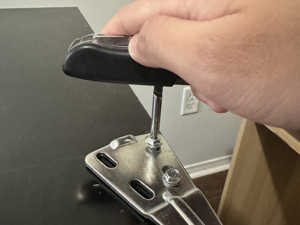

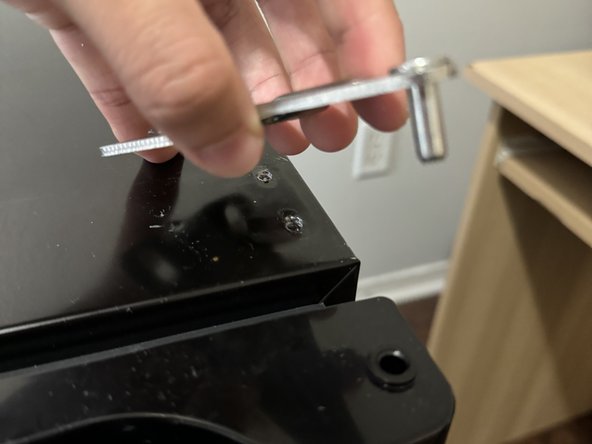

    • Unscrew the hinge counterclockwise.
  5. Midea MRU03M2ABB Upright Freezer Door Replacement: crwdns2935265:05crwdnd2935265:01crwdnd2935265:02crwdne2935265:0 Midea MRU03M2ABB Upright Freezer Door Replacement: crwdns2935265:05crwdnd2935265:02crwdnd2935265:02crwdne2935265:0

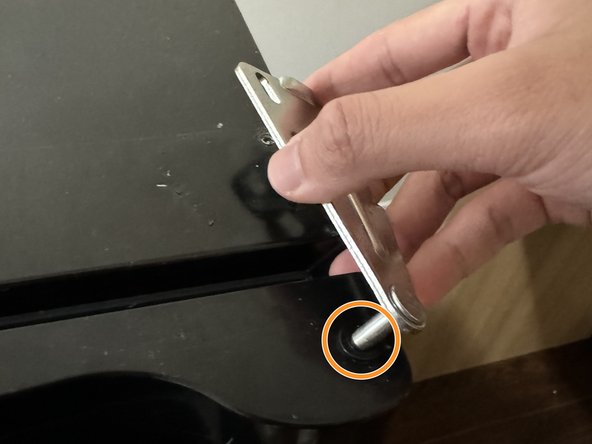

    • Lift the hinge out of the freezer and the door.

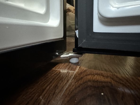

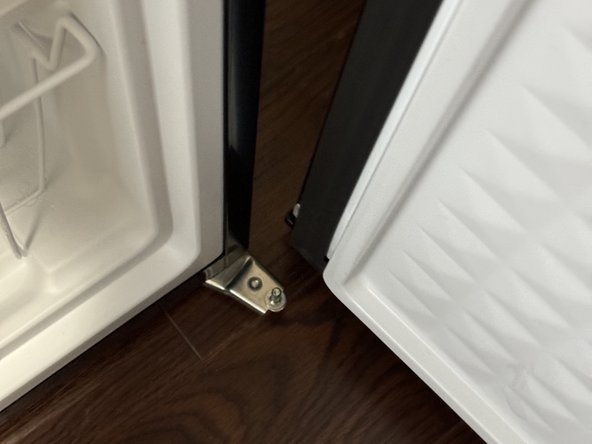

  6. Midea MRU03M2ABB Upright Freezer Door Replacement: crwdns2935265:06crwdnd2935265:01crwdnd2935265:03crwdne2935265:0 Midea MRU03M2ABB Upright Freezer Door Replacement: crwdns2935265:06crwdnd2935265:02crwdnd2935265:03crwdne2935265:0 Midea MRU03M2ABB Upright Freezer Door Replacement: crwdns2935265:06crwdnd2935265:03crwdnd2935265:03crwdne2935265:0
    • With two hands, gently hold and open the door as usual.
    • Lift the door up to remove it from the bottom hinge.
    • You have completely detached the door from the freezer.

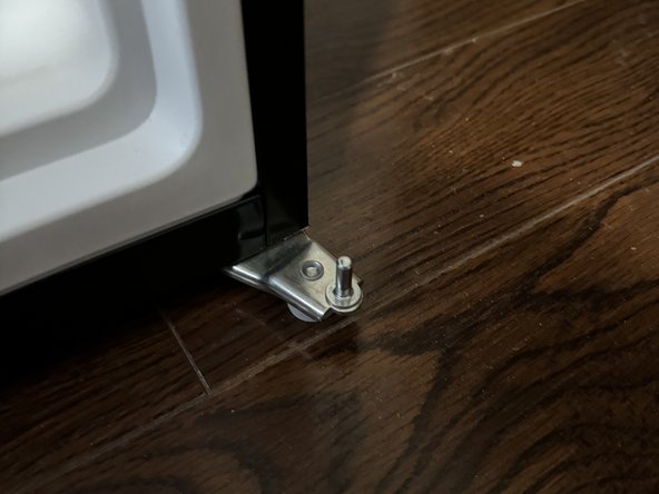

  7. Midea MRU03M2ABB Upright Freezer Door Replacement: crwdns2935265:07crwdnd2935265:01crwdnd2935265:03crwdne2935265:0 Midea MRU03M2ABB Upright Freezer Door Replacement: crwdns2935265:07crwdnd2935265:02crwdnd2935265:03crwdne2935265:0 Midea MRU03M2ABB Upright Freezer Door Replacement: crwdns2935265:07crwdnd2935265:03crwdnd2935265:03crwdne2935265:0

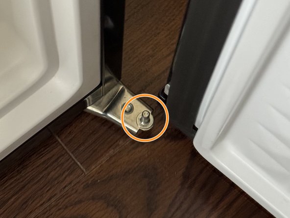

    • With the new door, locate the hole underneath the door.
    • Using two hands, gently place the door on top of the hinge (the pointy part of the hinge should fit inside the hole).
    • Close the door.

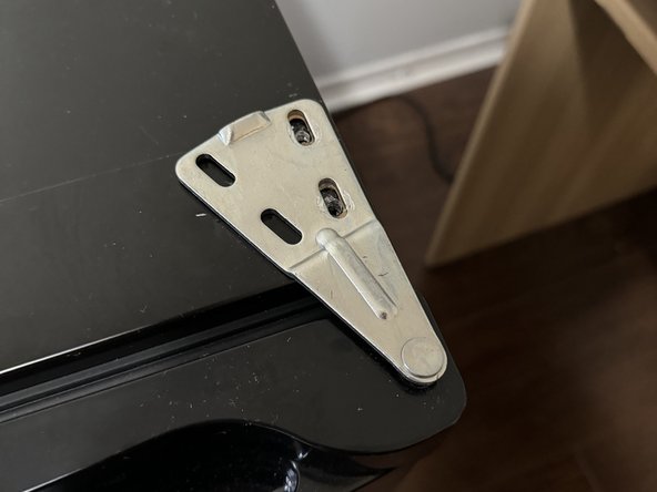

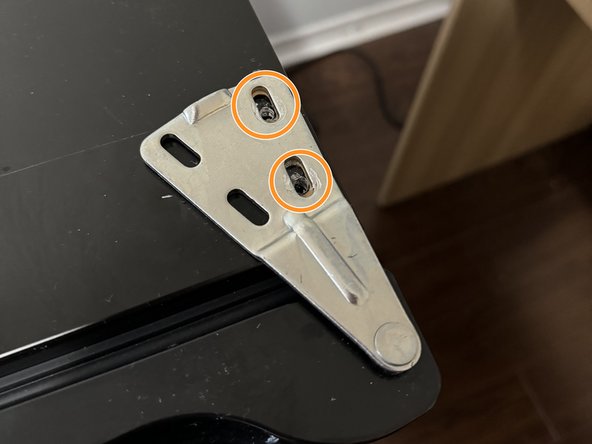

  8. Midea MRU03M2ABB Upright Freezer Door Replacement: crwdns2935265:08crwdnd2935265:01crwdnd2935265:03crwdne2935265:0 Midea MRU03M2ABB Upright Freezer Door Replacement: crwdns2935265:08crwdnd2935265:02crwdnd2935265:03crwdne2935265:0 Midea MRU03M2ABB Upright Freezer Door Replacement: crwdns2935265:08crwdnd2935265:03crwdnd2935265:03crwdne2935265:0
    • Use your hand to align the door so these three screw holes stay on the same line.
    • Carefully place the top hinge to fit these holes.
  9. Midea MRU03M2ABB Upright Freezer Door Replacement: crwdns2935265:09crwdnd2935265:01crwdnd2935265:02crwdne2935265:0 Midea MRU03M2ABB Upright Freezer Door Replacement: crwdns2935265:09crwdnd2935265:02crwdnd2935265:02crwdne2935265:0
    • Thread and tighten the screws clockwise.
    • Gently swing the door to make sure it operates well.
