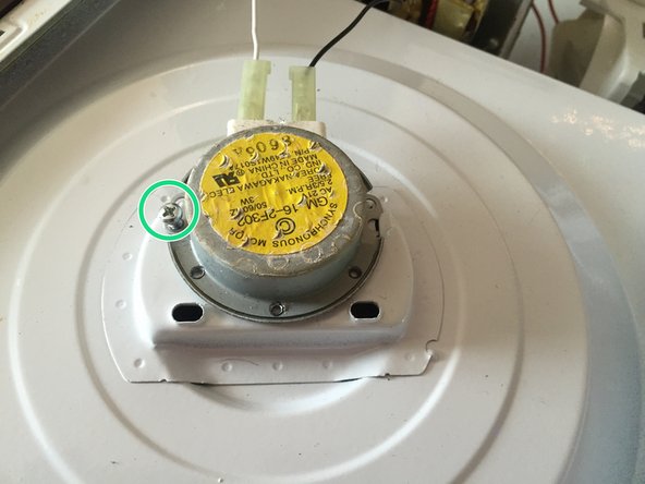

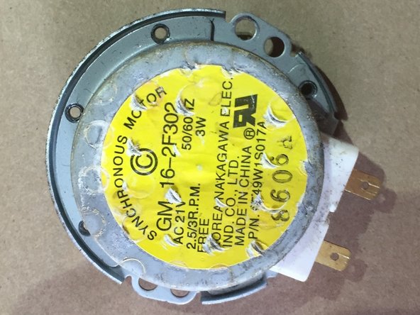

  6. Microwave Teardown, Disconnect turntable motor: crwdns2935265:06crwdnd2935265:01crwdnd2935265:03crwdne2935265:0 Microwave Teardown, Disconnect turntable motor: crwdns2935265:06crwdnd2935265:02crwdnd2935265:03crwdne2935265:0 Microwave Teardown, Disconnect turntable motor: crwdns2935265:06crwdnd2935265:03crwdnd2935265:03crwdne2935265:0
    • Unplug the two power wires for the motor with a yellow sticker on it.
    • Disconnect single phillips screw on motor, pull motor off white microwave mounting, and set aside.

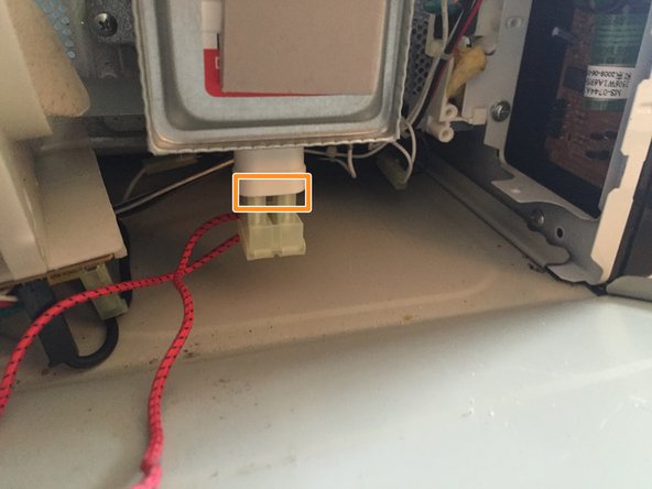

  13. Microwave Teardown, Remove magnetron: crwdns2935265:013crwdnd2935265:01crwdnd2935265:02crwdne2935265:0 Microwave Teardown, Remove magnetron: crwdns2935265:013crwdnd2935265:02crwdnd2935265:02crwdne2935265:0
    • The magnetron is the heart of the microwave oven, since it ultimately converts voltage to microwaves.
    • Disconnect the red wire connector protruding from the bottom of the magnetron.
    • Remove 4 phillips screws holding the magnetron to the food compartment. Set the magnetron aside.
