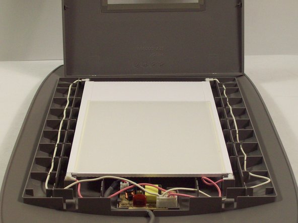

  2. Microtek ScanMaker 5900 New Upper Lid Bulbs Replacement, Remove Lid: crwdns2935265:02crwdnd2935265:01crwdnd2935265:03crwdne2935265:0 Microtek ScanMaker 5900 New Upper Lid Bulbs Replacement, Remove Lid: crwdns2935265:02crwdnd2935265:02crwdnd2935265:03crwdne2935265:0 Microtek ScanMaker 5900 New Upper Lid Bulbs Replacement, Remove Lid: crwdns2935265:02crwdnd2935265:03crwdnd2935265:03crwdne2935265:0
    • Lift lid to its vertical position.
    • Pull lid straight up to remove it from the scanner.

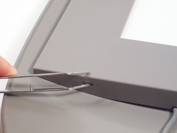

  3. Microtek ScanMaker 5900 New Upper Lid Bulbs Replacement, Remove the protective plastic covering: crwdns2935265:03crwdnd2935265:01crwdnd2935265:03crwdne2935265:0 Microtek ScanMaker 5900 New Upper Lid Bulbs Replacement, Remove the protective plastic covering: crwdns2935265:03crwdnd2935265:02crwdnd2935265:03crwdne2935265:0 Microtek ScanMaker 5900 New Upper Lid Bulbs Replacement, Remove the protective plastic covering: crwdns2935265:03crwdnd2935265:03crwdnd2935265:03crwdne2935265:0
    • Notice that there are two plastic tabs that need to be pushed in to remove the plastic covering.
    • Use tweezers to push these tabs in.
    • Gently pull the plastic covering off of the upper lid.

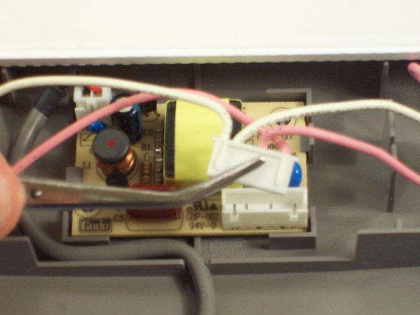

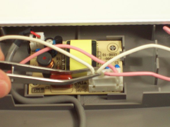

  4. Microtek ScanMaker 5900 New Upper Lid Bulbs Replacement, Remove wires from circuit board: crwdns2935265:04crwdnd2935265:01crwdnd2935265:03crwdne2935265:0 Microtek ScanMaker 5900 New Upper Lid Bulbs Replacement, Remove wires from circuit board: crwdns2935265:04crwdnd2935265:02crwdnd2935265:03crwdne2935265:0 Microtek ScanMaker 5900 New Upper Lid Bulbs Replacement, Remove wires from circuit board: crwdns2935265:04crwdnd2935265:03crwdnd2935265:03crwdne2935265:0
    • Grab the plastic wire housing near the serial port.
    • Gently pull and jiggle the wire housing until it comes free from the circuit board.

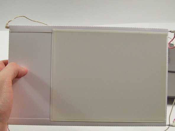

  5. Microtek ScanMaker 5900 New Upper Lid Bulbs Replacement, Remove the bulbs: crwdns2935265:05crwdnd2935265:01crwdnd2935265:02crwdne2935265:0 Microtek ScanMaker 5900 New Upper Lid Bulbs Replacement, Remove the bulbs: crwdns2935265:05crwdnd2935265:02crwdnd2935265:02crwdne2935265:0
    • Gently lift up the bulbs and remove the wires from the plastic.
    • After completely freeing the bulbs, buy new ones and replace.
