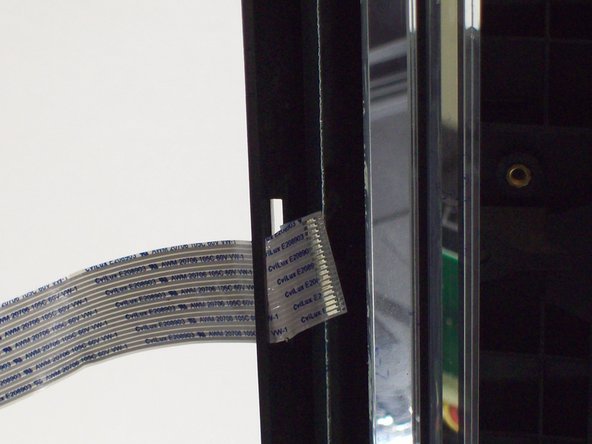

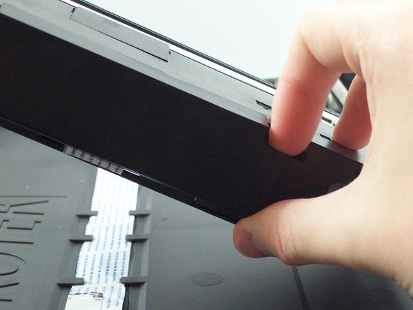

    3. Microtek ScanMaker 5900 New Ribbon Cable Replacement, Fully remove the upper lid: crwdns2935265:05crwdnd2935265:01crwdnd2935265:03crwdne2935265:0 Microtek ScanMaker 5900 New Ribbon Cable Replacement, Fully remove the upper lid: crwdns2935265:05crwdnd2935265:02crwdnd2935265:03crwdne2935265:0 Microtek ScanMaker 5900 New Ribbon Cable Replacement, Fully remove the upper lid: crwdns2935265:05crwdnd2935265:03crwdnd2935265:03crwdne2935265:0
      • Do not fully remove the lid until you remove the ribbon cable attached to the front of the upper lid.
      • Do this by grabbing the upper lid from the sides and rotating it ninety degrees so it is perpendicular to the bottom lid.
      • Grab the ribbon cable and gently pull it out of its slot with your fingers.
      • The upper lid can now safely be removed from the bottom lid.

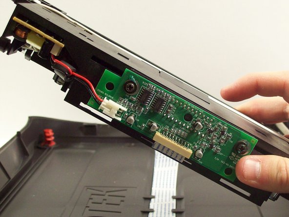

    1. Microtek ScanMaker 5900 New Ribbon Cable Replacement, Remove outer plastic housing: crwdns2935265:06crwdnd2935265:01crwdnd2935265:03crwdne2935265:0 Microtek ScanMaker 5900 New Ribbon Cable Replacement, Remove outer plastic housing: crwdns2935265:06crwdnd2935265:02crwdnd2935265:03crwdne2935265:0 Microtek ScanMaker 5900 New Ribbon Cable Replacement, Remove outer plastic housing: crwdns2935265:06crwdnd2935265:03crwdnd2935265:03crwdne2935265:0
      • Lift up the central plastic housing inside the scanner.
      • There are four plastic tabs located on the outer plastic housing. Push on each of these and pull to remove it.
      • Underneath you will see that the ribbon cable is attached to the circuit board.

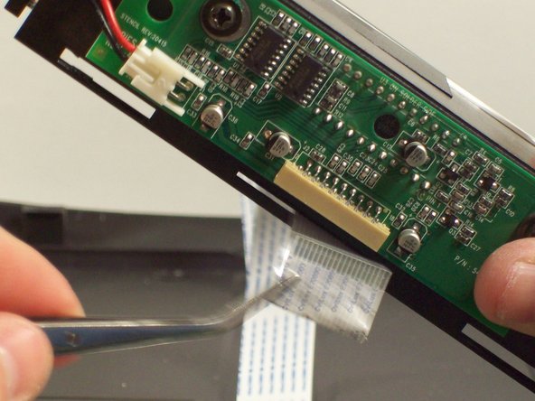

    2. Microtek ScanMaker 5900 New Ribbon Cable Replacement, Remove ribbon cable from circuit board: crwdns2935265:07crwdnd2935265:01crwdnd2935265:02crwdne2935265:0 Microtek ScanMaker 5900 New Ribbon Cable Replacement, Remove ribbon cable from circuit board: crwdns2935265:07crwdnd2935265:02crwdnd2935265:02crwdne2935265:0
      • Grab onto ribbon cable with tweezers and gently pull until it come outs.

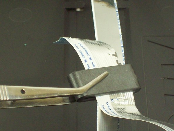

    3. Microtek ScanMaker 5900 New Ribbon Cable Replacement, Remove ribbon cable from central plastic housing: crwdns2935265:08crwdnd2935265:01crwdnd2935265:02crwdne2935265:0 Microtek ScanMaker 5900 New Ribbon Cable Replacement, Remove ribbon cable from central plastic housing: crwdns2935265:08crwdnd2935265:02crwdnd2935265:02crwdne2935265:0
      • Simply remove the ribbon cable from within the holes it is wrapped through.
    4. Microtek ScanMaker 5900 New Ribbon Cable Replacement, Remove the ribbon cable from between the plastic prongs on the bottom of the scanner.: crwdns2935265:09crwdnd2935265:01crwdnd2935265:01crwdne2935265:0
      • Grab the ribbon cable, and gently pull it off of the bottom of the scanner.

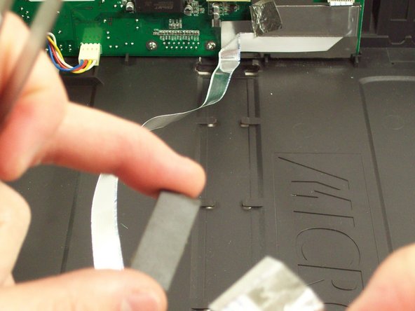

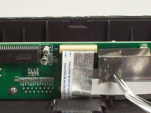

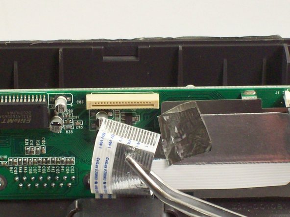

    5. Microtek ScanMaker 5900 New Ribbon Cable Replacement, Remove ribbon cable from circuit board: crwdns2935265:010crwdnd2935265:01crwdnd2935265:03crwdne2935265:0 Microtek ScanMaker 5900 New Ribbon Cable Replacement, Remove ribbon cable from circuit board: crwdns2935265:010crwdnd2935265:02crwdnd2935265:03crwdne2935265:0 Microtek ScanMaker 5900 New Ribbon Cable Replacement, Remove ribbon cable from circuit board: crwdns2935265:010crwdnd2935265:03crwdnd2935265:03crwdne2935265:0
      • Peel back the sticky metal from the other side of the ribbon cable.
      • Use tweezers to gently remove the ribbon cable from the circuit board.
    6. Microtek ScanMaker 5900 New Ribbon Cable Replacement, Remove ribbon cable: crwdns2935265:011crwdnd2935265:01crwdnd2935265:03crwdne2935265:0 Microtek ScanMaker 5900 New Ribbon Cable Replacement, Remove ribbon cable: crwdns2935265:011crwdnd2935265:02crwdnd2935265:03crwdne2935265:0 Microtek ScanMaker 5900 New Ribbon Cable Replacement, Remove ribbon cable: crwdns2935265:011crwdnd2935265:03crwdnd2935265:03crwdne2935265:0
      • Remove the metal housing for the ribbon cable at the base of the scanner.
      • Use the tweezers to slide off the metal housing.
      • The ribbon cable is now completely free to be replaced.
