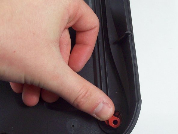

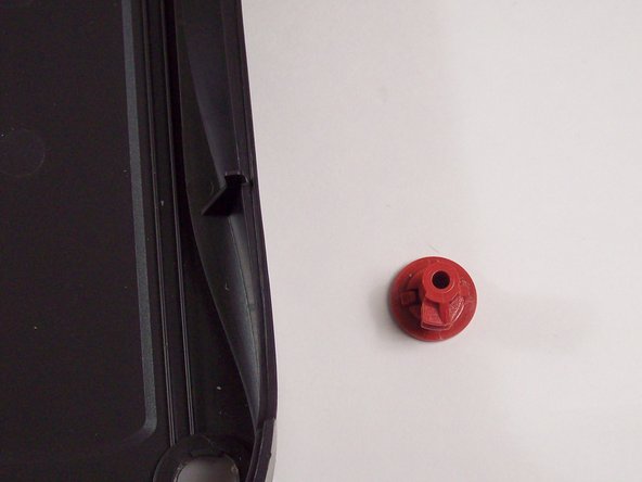

    1. Microtek ScanMaker 5900 New Locking Mechanism Replacement, Remove locking mechanism: crwdns2935265:06crwdnd2935265:01crwdnd2935265:03crwdne2935265:0 Microtek ScanMaker 5900 New Locking Mechanism Replacement, Remove locking mechanism: crwdns2935265:06crwdnd2935265:02crwdnd2935265:03crwdne2935265:0 Microtek ScanMaker 5900 New Locking Mechanism Replacement, Remove locking mechanism: crwdns2935265:06crwdnd2935265:03crwdnd2935265:03crwdne2935265:0
      • Locate the locking mechanism in the front left hand corner of the device.
      • Gently push on it until it becomes loose.
      • Rotate and jiggle it until it comes out the bottom of the scanner.
      • Find a replacement locking mechanism and insert it into the scanner.
