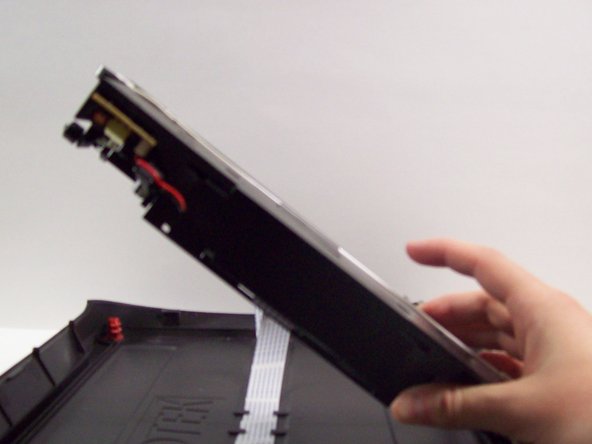

    3. Microtek ScanMaker 5900 New Bulb Replacement, Fully remove the upper lid: crwdns2935265:05crwdnd2935265:01crwdnd2935265:03crwdne2935265:0 Microtek ScanMaker 5900 New Bulb Replacement, Fully remove the upper lid: crwdns2935265:05crwdnd2935265:02crwdnd2935265:03crwdne2935265:0 Microtek ScanMaker 5900 New Bulb Replacement, Fully remove the upper lid: crwdns2935265:05crwdnd2935265:03crwdnd2935265:03crwdne2935265:0
      • Do not fully remove the lid until you remove the ribbon cable attached to the front of the upper lid.
      • Do this by grabbing the upper lid from the sides and rotating it ninety degrees so it is perpendicular to the bottom lid.
      • Grab the ribbon cable and gently pull it out of its slot with your fingers.
      • The upper lid can now safely be removed from the bottom lid.

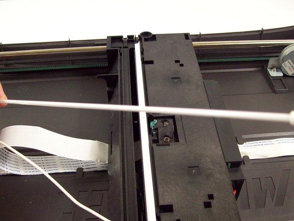

    1. Microtek ScanMaker 5900 New Bulb Replacement, Locate the bulb: crwdns2935265:06crwdnd2935265:01crwdnd2935265:02crwdne2935265:0 Microtek ScanMaker 5900 New Bulb Replacement, Locate the bulb: crwdns2935265:06crwdnd2935265:02crwdnd2935265:02crwdne2935265:0
      • After opening the chassis, you will see a white bulb spanning the width of the scanner.
      • Lift up the black piece of plastic the bulb is attached to from the left hand side until it is perpendicular with the bottom lid of the scanner.

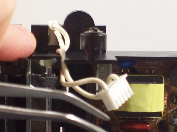

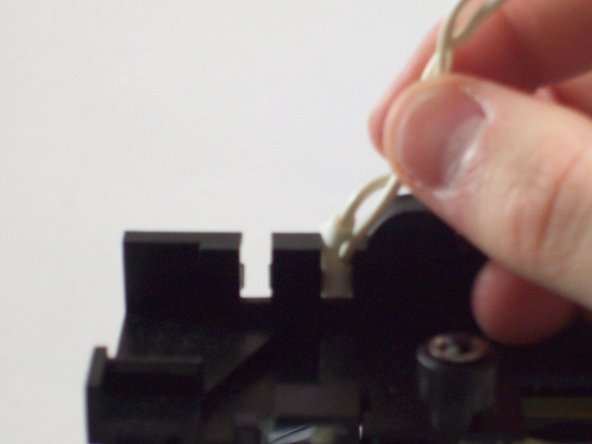

    2. Microtek ScanMaker 5900 New Bulb Replacement, Detach the bulb electrical connection: crwdns2935265:07crwdnd2935265:01crwdnd2935265:03crwdne2935265:0 Microtek ScanMaker 5900 New Bulb Replacement, Detach the bulb electrical connection: crwdns2935265:07crwdnd2935265:02crwdnd2935265:03crwdne2935265:0 Microtek ScanMaker 5900 New Bulb Replacement, Detach the bulb electrical connection: crwdns2935265:07crwdnd2935265:03crwdnd2935265:03crwdne2935265:0
      • Use tweezers to grab the plastic casing the wires are housed in.
      • Gently jiggle the plastic back and forth until it can be pulled from its connection.
      • Pull the wires out of the circuit board.
      • Pull the wires up and out over the top of the plastic housing.

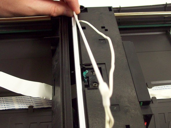

    3. Microtek ScanMaker 5900 New Bulb Replacement, Remove the bulb: crwdns2935265:08crwdnd2935265:01crwdnd2935265:03crwdne2935265:0 Microtek ScanMaker 5900 New Bulb Replacement, Remove the bulb: crwdns2935265:08crwdnd2935265:02crwdnd2935265:03crwdne2935265:0 Microtek ScanMaker 5900 New Bulb Replacement, Remove the bulb: crwdns2935265:08crwdnd2935265:03crwdnd2935265:03crwdne2935265:0
      • Place the plastic housing back into the bottom lid of the scanner.
      • Remove the plastic panel by gently pushing on the plastic latches with a plastic opening tool.
      • Pull the bulb and wire out of its plastic casing.
      • The bulb is now free to be replaced.
