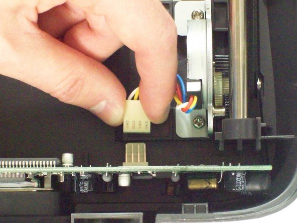

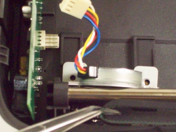

      • Locate the stepper motor. With the front of the scanner facing you, the motor is located at the top left.
      • Disconnect the white connector from the vertical standing circuit board.

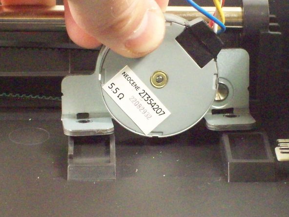

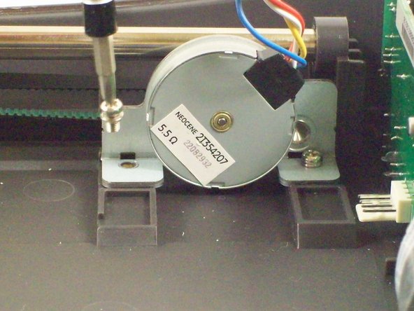

      • Using a #2 Philips Screwdriver, unscrew the two 7.7mm screws holding the stepper motor in place.
      • The stepper motor will become loose, but not completely free.

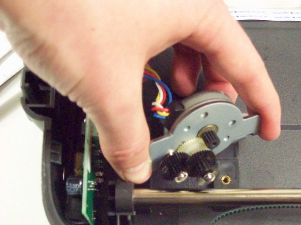

      • Using tweezers gently remove the tread from the black gear on the stepper motor.
      • The stepper motor will become completely free.

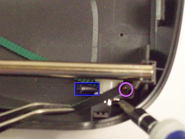

      • Facing the front of the scanner you will see a white plastic wheel holding the other end of the tread.
      • Pull the spring towards you until it snaps off the side wall releasing the tension in the spring.
      • Using a #2 Philips Screwdriver, unscrew the single 5.88mm screw holding the mount of the plastic wheel in place.
