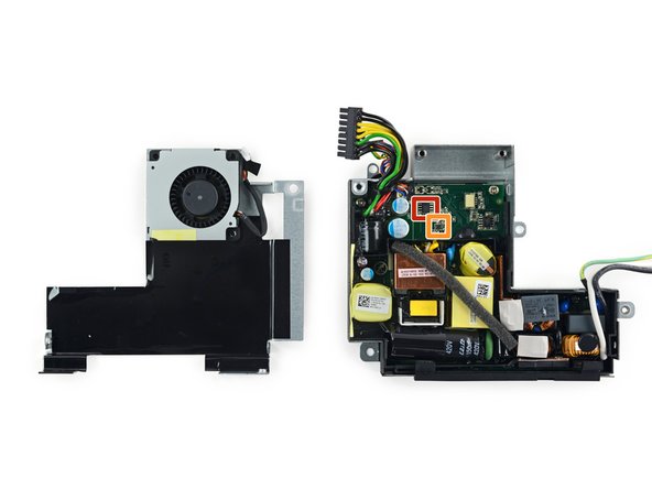

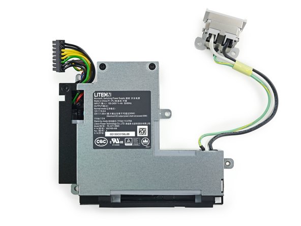

    • From here we're able to pull out the power supply, a custom Lite-On unit with a dual-voltage (100-240 V) rating.
    • The power supply features its own small, internal cooling fan. Our button fingers twitch involuntarily; we're having Xbox One flashbacks.
    • Overall impressions: it's a power supply. It's a beefy, well-insulated power supply. Are you happy? Alright then. Moving on.
    • IC Identification:
    • NXP Semiconductor TEA1995T dual synchronous rectifier controller
    • STMicroelectronics STTS751-0DP3F digital temperature sensor

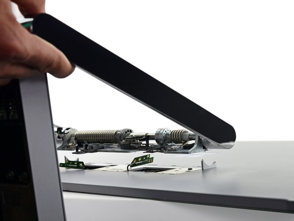

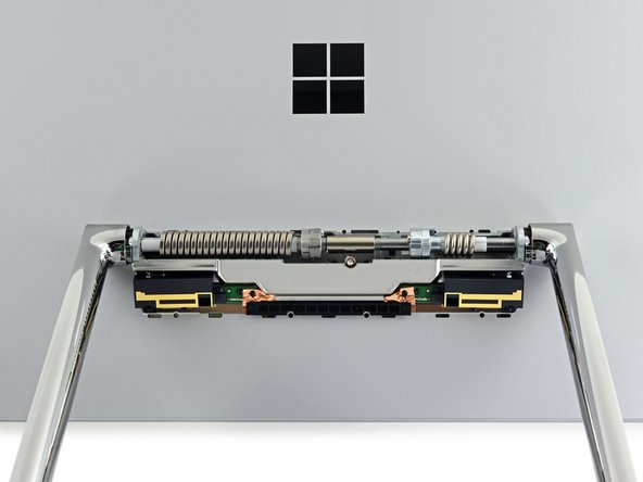

    • We temporarily shift our attention to a more screw-y, less glue-y portion of this desktop, in the hopes that we will have more luck in removing it.
    • Lacking a specialized tool for the job, we hand-beast the hinge casing off the back of the display. A slew of tiny clips keep it tightly stuck, with no adhesive or screws.
    • Underneath lurks a pair of antennas, significantly-more-than-a-pair of springs, and loads of screws.
    • The multiple spring mechanisms allow the monitor to transition from vertical to nearly-horizontal with just a light touch.
    • Removing the screws securing the hinge to the display is like playing Russian Roulette: some are spring-loaded while others are not. We test our odds, and manage to select all of the correct screws for removal, detaching the base without a springtastic explosion.
  17. Microsoft Surface Studio Teardown: crwdns2935265:018crwdnd2935265:01crwdnd2935265:02crwdne2935265:0 Microsoft Surface Studio Teardown: crwdns2935265:018crwdnd2935265:02crwdnd2935265:02crwdne2935265:0

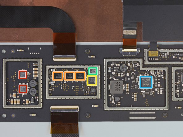

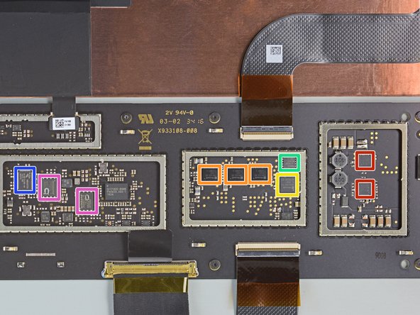

  19. Microsoft Surface Studio Teardown: crwdns2935265:020crwdnd2935265:01crwdnd2935265:03crwdne2935265:0 Microsoft Surface Studio Teardown: crwdns2935265:020crwdnd2935265:02crwdnd2935265:03crwdne2935265:0 Microsoft Surface Studio Teardown: crwdns2935265:020crwdnd2935265:03crwdnd2935265:03crwdne2935265:0

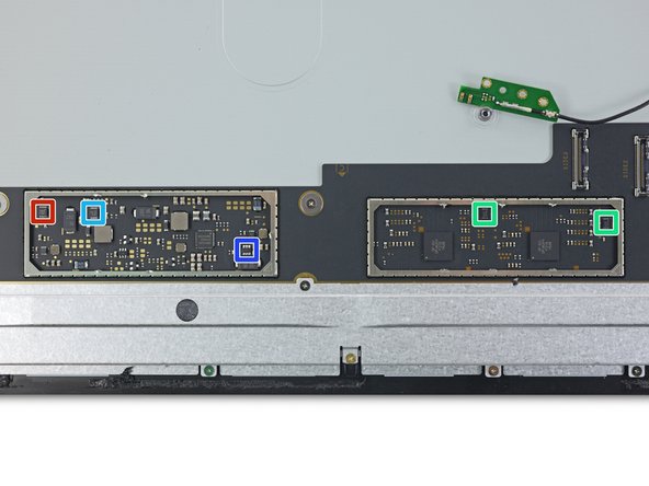

    • Hiding behind the display we find the other half of the motherboard. Seriously, there's way more silicon hiding in this unit than in the base. Highlights include:
    • Monolithic Power Systems MP3387LLED driving, step-up converter (x4)
    • Microsoft X904169 05 CL1631 T518907.1 (x6) likely touchscreen controller
    • Microsoft X904163 01 CL1634 4C39290-01 (x2) likely touchscreen controller
    • Macronix MX25U1635F serial NOR flash (x2)
    • Atmel ATSAMS70N21 32-bit ARM Cortex-M7 processor
    • Novatech NT96131QG-46 likely camera controller
    • Winbond W25X20CL 2 Mb Serial NOR Flash Memory (x2)

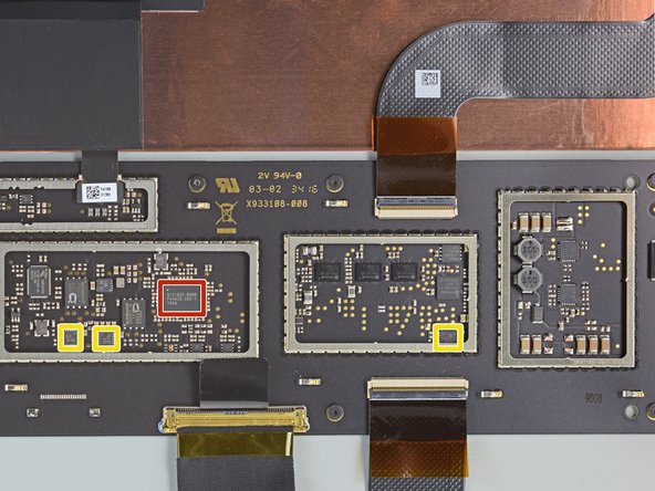

  20. Microsoft Surface Studio Teardown: crwdns2935265:021crwdnd2935265:01crwdnd2935265:02crwdne2935265:0 Microsoft Surface Studio Teardown: crwdns2935265:021crwdnd2935265:02crwdnd2935265:02crwdne2935265:0
    • IC Identification, continued:
    • Unknown QIC1832-B98B ? programmable gamma buffer (likely)
    • STMicroelectronics STTS751-1DP3F digital temperature sensor
    • Richtek RT9059GQW 3 A LDO regulator
    • Texas Instruments TLV3011 comparator w/ voltage reference
    • Monolithic Power Systems NB671GQ6 A synchronous step-down converter
    • Monolithic Power Systems DC-DC converter
    • Texas Instruments SN74LVC1G3157 SPDT analog switch

    • NXP TFA9890A (x2) high efficiency class-D audio amplifier
    • Marvell 88W8897 WLAN + BT4.0 + NFC Combo Chip (as seen in past Surface devices)
    • Mediatek MT7600UAN (likely integrated Wi-Fi SoC, as seen in the Xbox One Wireless Receiver)
    • Silicon Mitus SM4142A display power management
    • MegaChips F216 timing controller (likely)
    • Last off the display is the sensor bar with microphones, IR projector and camera combination that powers Windows Hello, along with the built-in 5 MP webcam.
    • MaxLinear (formerly Exar) iML2811 voltage reference buffer
    • Macronix MX25L512ZUI-12G 512 Kb serial NOR flash memory
    • Rohm BR24T16-W 16 Kb serial EEPROM memory
    • STMicroelectronics M24C32-W 32 Kb serial EEPROM memory (likely)
    • Maxim Integrated MAX17112 LCD step-up DC-DC converter
    • Texas Instruments TPS3808G12 current supervisor
    • Monolithic Power Systems NB671LBGQ and NB671GQ DC-DC converter

    • We dug way below the surface of this Studio, and here are all the bits we found! Well. Mostly.
  24. crwdns2935195:0crwdne2935195:0
    • The base is easy to open and home to several modular components—including the standard SATA hard drive and M.2 SSD—that can be replaced without disassembling the display.
    • The entire display assembly can be replaced as a piece, without dismantling the display or the base.
    • The RAM, CPU, and GPU are soldered to the board and cannot be upgraded. You may want to think twice about that 8 GB configuration.
    • A few components embedded in the display (buttons, front sensors, and speakers) will be difficult to replace if they fail.
