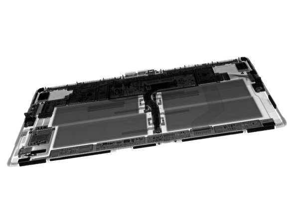

    • If you need a teardown TL;DR, here's an X-ray overview from Creative Electron showing everything on our agenda.

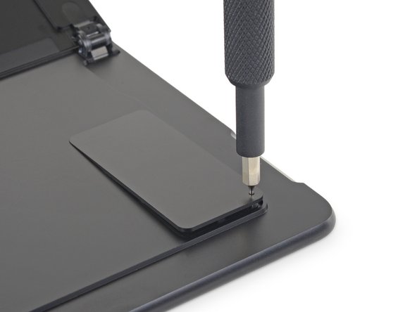

    • And if you look closely, you'll find the faint outline of what can only be described as a secret trap door in the Pro X. Lucky for us, it's not guarded by a three-headed dog.
    • We poke the (magnetically secured!) trap door with our SIM eject bit, and...
    • Voilà! Underneath, an SSD (held down by a T3 screw) and a SIM slot!
    • And hey, this SSD looks super familiar. A quick comparison with the 256 GB drive we pulled from the Surface Laptop 3 confirms both devices are using the same drive. Standardization is great for repairs!
    • As an experiment, we try powering on the Pro X sans-SSD, and... no sign of life. We wouldn't expect it to boot up—but it's so dead, we sort of suspect the SSD acts as a battery kill switch like we found in the Laptop 3.

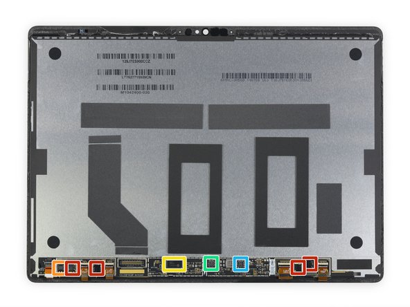

    • While relatively painless, this opening procedure is not without hurdles—we see a few flex cables along the bottom of the display, dangerously close to the path of our cutting tools.
    • That said, it gets even painless-er when we start removing the adhesive. It peels off like magic—no mess! This is the kind of change we've been pleading for. If you must glue together a super thin, space-constrained device, this is how you should do it. (But don't do it on a desktop, okay? Because that's just lame.)
    • Our excitement is real, but let's pause to peruse these display chips. We've got:
    • Microsoft X904163 and X904169 display drivers
    • Winbond Q16FWUXB2 1921-681C DR80006
    • Analogix ANX2684 1920 C975AA
    • SiW SW50014A 8266631T 1844
    • SiW SW5077 J004370V 1920

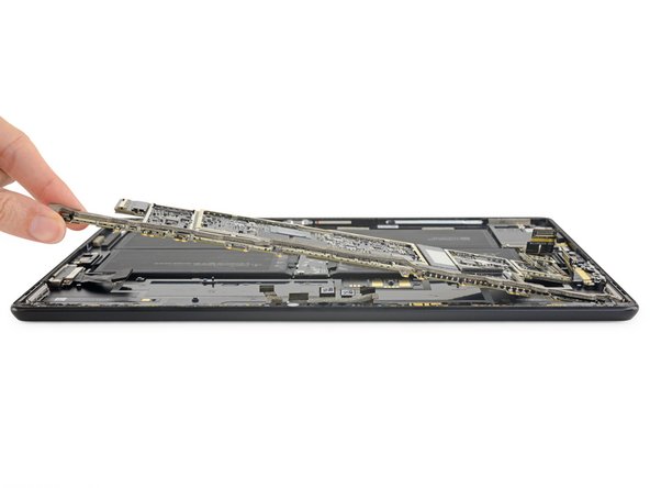

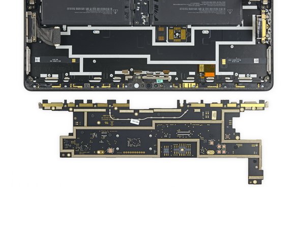

    • With the heat sink and quite a few shields and screws out of the way, the motherboard slides out. Time for some silicon sleuthing!
  7. Microsoft Surface Pro X Teardown: crwdns2935265:07crwdnd2935265:01crwdnd2935265:01crwdne2935265:0
    • Here's what we dug up:
    • Microsoft SQ1 3.0 GHz ARM processor
    • Samsung K3UH5H50AMJGCL 4 GB LPDDR4X RAM x2, for 8 GB total
    • NXP LPC54S00TJ EV180 microcontroller
    • Macronix MX25U1635E serial NOR flash memory
    • Winbond 26Q256JW 256 Mb serial flash memory
    • Qualcomm SDR8150 RF transceiver and modem
    • Qorvo 78052 14CEM RF Fusion MHB
  8. Microsoft Surface Pro X Teardown: crwdns2935265:08crwdnd2935265:01crwdnd2935265:03crwdne2935265:0 Microsoft Surface Pro X Teardown: crwdns2935265:08crwdnd2935265:02crwdnd2935265:03crwdne2935265:0 Microsoft Surface Pro X Teardown: crwdns2935265:08crwdnd2935265:03crwdnd2935265:03crwdne2935265:0

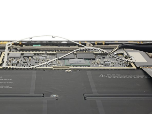

    • The back side of board is devoid of interesting silicon, but we can't help but notice the strange silver jumper wire clinging to it. Hey wait a minute, this thing actually looks kinda familiar.
    • What's it for? You're welcome to inspect where it's routed and try to guess!
    • We think it may be a shielded diversity antenna of some kind, with a grounded exterior to insulate RF to and from the interior signal lead. The accompanying sticker NEW SAM could be labelling the wire as a Surface Antenna Mount.
    • That said, NEW SAM could be anything: Super Activity Monitor; Silver Aerobic Master; Slippery Agile Meerkat; Solidified Aerodynamic Meter ... The possibilities are endless. Leave your NEW SAM guesses in the comments below.

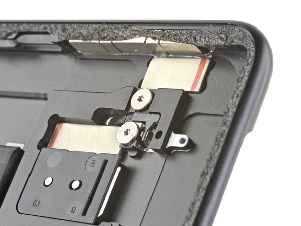

    • We're used to seeing some fancy mechanics driving the kickstand hinge in these Surface Pros, but this time we're treated to even more fancy mechanics.
    • The SSD cover sits on one side of a tiny see-saw, waiting for a friendly SIM eject tool or paperclip to come along and sit on the other side. When that happens, the see-saw pushes the SSD cover away from the case, and bam! Just like that you can upgrade your storage.
    • When we're done at the world's smallest playground, we move over to the SSD interface and SIM reader, which come out as one module.
    • We're intrigued by how much space this module takes up, and all the more impressed that Microsoft carved out the necessary real estate to include such a repair-friendly feature in a tablet as thin and light as the Pro X.

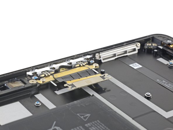

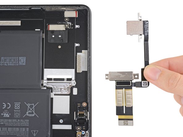

    • What's left? Modular USB ports, flanked by the kickstand hinge mechanism and the case buttons. And at the far end lies the Surface Connect port—also modular.
    • You may be surprised to read the word modular so much in a Surface Pro teardown. So are we! We've done some deep breathing and pinched ourselves multiple times, but this does appear to be reality.
