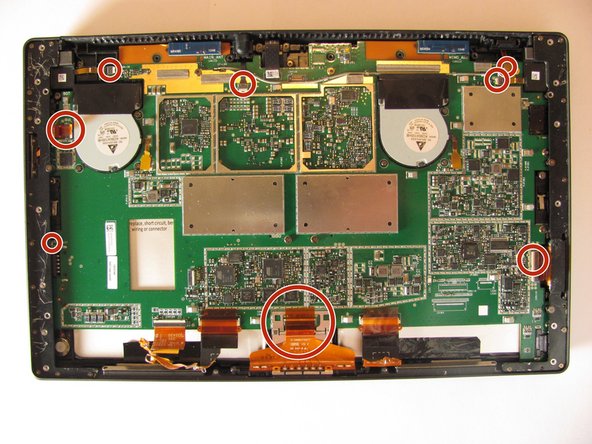

      • Using tweezers, gently pull the eight orange ribbon cables from their sockets.
    6. Microsoft Surface Pro Battery Replacement: crwdns2935265:010crwdnd2935265:01crwdnd2935265:02crwdne2935265:0 Microsoft Surface Pro Battery Replacement: crwdns2935265:010crwdnd2935265:02crwdnd2935265:02crwdne2935265:0
      • Unscrew the 17 T5 torx screws on the mother board with the T5 torx screw driver
    7. Microsoft Surface Pro Battery Replacement: crwdns2935265:011crwdnd2935265:01crwdnd2935265:01crwdne2935265:0
      • Once all screws are removed, gently lift up the logic board with your hands to pull it out.
    8. Microsoft Surface Pro Battery Replacement: crwdns2935265:012crwdnd2935265:01crwdnd2935265:02crwdne2935265:0 Microsoft Surface Pro Battery Replacement: crwdns2935265:012crwdnd2935265:02crwdnd2935265:02crwdne2935265:0
      • Use your hands to pry off the entire battery pack with enough force to overcome the glue keeping the batteries in place.
