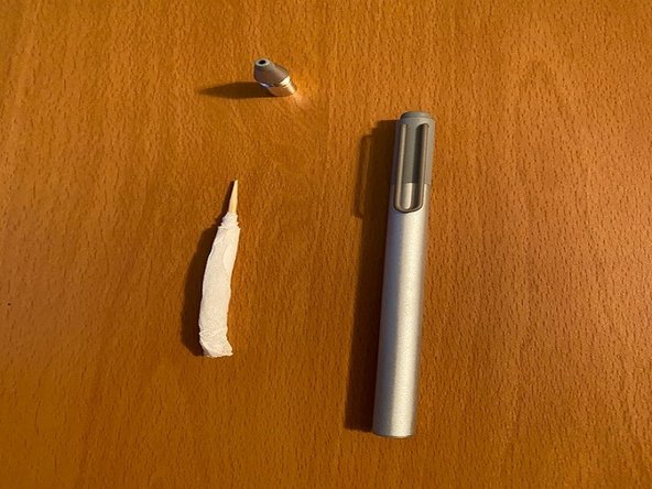

  3. Microsoft Surface Pen Tip Replacement: crwdns2935265:03crwdnd2935265:01crwdnd2935265:03crwdne2935265:0 Microsoft Surface Pen Tip Replacement: crwdns2935265:03crwdnd2935265:02crwdnd2935265:03crwdne2935265:0 Microsoft Surface Pen Tip Replacement: crwdns2935265:03crwdnd2935265:03crwdnd2935265:03crwdne2935265:0
    • After you extract the tip, roll the tissue on toothpick.
    • I recommend cutting the tissue in half.
  4. Microsoft Surface Pen Tip Replacement: crwdns2935265:04crwdnd2935265:01crwdnd2935265:03crwdne2935265:0 Microsoft Surface Pen Tip Replacement: crwdns2935265:04crwdnd2935265:02crwdnd2935265:03crwdne2935265:0 Microsoft Surface Pen Tip Replacement: crwdns2935265:04crwdnd2935265:03crwdnd2935265:03crwdne2935265:0
    • Clean the inside of the top detachable part of the pen with a toothpick covered with tissue.
    • Make sure there is no residue on the edge.
