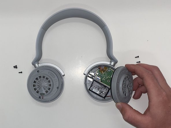

    • Firmly grasp the ear cushions, and rotate them counterclockwise about 45 degrees, or until you hear a "click."
    • Be careful not to use excessive force during rotation.
  2. Microsoft Surface Headphones Speaker Replacement: crwdns2935265:02crwdnd2935265:01crwdnd2935265:01crwdne2935265:0
    • Lift the ear cushions off the speaker housings.
  3. Microsoft Surface Headphones Speaker Replacement, Speaker: crwdns2935265:03crwdnd2935265:01crwdnd2935265:02crwdne2935265:0 Microsoft Surface Headphones Speaker Replacement, Speaker: crwdns2935265:03crwdnd2935265:02crwdnd2935265:02crwdne2935265:0
    • Remove the six 2.6mm screws with a Phillips #00 screwdriver, and gently lift the speaker housings away.
    • If only one of the speakers is malfunctioning, only remove the screws on the affected side, and leave the functional speaker intact.

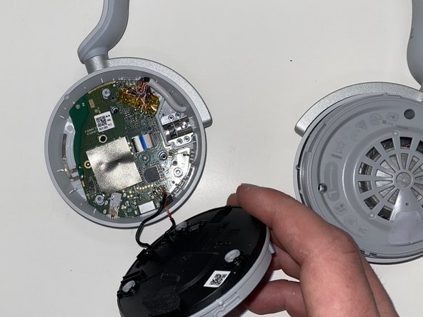

  4. Microsoft Surface Headphones Speaker Replacement: crwdns2935265:04crwdnd2935265:01crwdnd2935265:02crwdne2935265:0 Microsoft Surface Headphones Speaker Replacement: crwdns2935265:04crwdnd2935265:02crwdnd2935265:02crwdne2935265:0
    • Gently pry the speaker housing away from the chassis with a spudger.
  5. Microsoft Surface Headphones Speaker Replacement: crwdns2935265:05crwdnd2935265:01crwdnd2935265:01crwdne2935265:0
    • Desolder the speaker's motherboard connections.
    • Desoldering and soldering are delicate procedures, and there is a potential for device damage.

How do I remove the speaker from the plastic housing? Is it glued in place? I desoldered the speaker unit and now I am trying to take out speaker from its housing.
Stephen Hyland - crwdns2934203:0crwdne2934203:0
I would also like to know this! replacing the speaker requires the plastic housing to be opened. I tried heating the housing with a hair dryer but no result....
fixer8888 -
I cut it in half down the side. Very long a tedious process. also makes it hard to get a tight seal for reassembly but with a little more patience than I had and a clamp to glue the pieces together could probably get a nice finish. I have a gap which causes a little weirdness for the ANC especially with wind.
joshray -
@joshray how did you cut the plastic open exactly? Having the same issue and I also thought about cutting open the plastic housing to get to the speaker but am unsure how to do this exactly.
