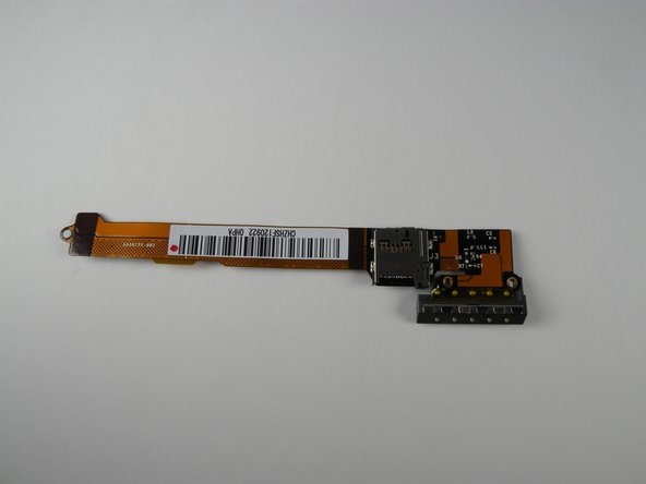

    1. Microsoft Surface Charging Port Replacement, Charging Port: crwdns2935265:07crwdnd2935265:01crwdnd2935265:03crwdne2935265:0 Microsoft Surface Charging Port Replacement, Charging Port: crwdns2935265:07crwdnd2935265:02crwdnd2935265:03crwdne2935265:0 Microsoft Surface Charging Port Replacement, Charging Port: crwdns2935265:07crwdnd2935265:03crwdnd2935265:03crwdne2935265:0
      • Orient the Surface so the side with the charging port is facing you.
      • Use your finger to lift the tab and unplug the orange ribbon from the motherboard.
      • Remove the two 3.6 mm T4 Torx screws that hold the charging port in place.
      • Remove the charging port by sliding it out from the main board.

Can anyone confirm whether this charging port will work for a Microsoft Surface 3 (non-pro)? The port is loose and cannot get a fitting connection with a micro-usb cable. Thank you.
Michael Zimmerman - crwdns2934203:0crwdne2934203:0 crwdns2950251:0crwdne2950251:0
Probably, As They Are The Same Aren’t They? I’d Say About 80% Chance Of It Working, Good Luck!
I’ll Have To Do This Myself Soon, All The Pins Seemed To Have Been Sucked Into The Actual Body Of The Device.
Callum Hull - crwdns2934203:0crwdne2934203:0 crwdns2950251:0crwdne2950251:0
Is the charging circuitry also located on this board or is it only the port?
rolfeilert1970 - crwdns2934203:0crwdne2934203:0 crwdns2950251:0crwdne2950251:0
The light on the charger connector is on when connected to the Surface. Does this suggest that the charger is working or that the Surface is charging? The unit will not turn on. When I turned it on earlier, I got the ‘low battery symbol’ on the screen but after charging I can get nothing on the screen. I am hesitant to take apart.
dickrwh - crwdns2934203:0crwdne2934203:0 crwdns2950251:0crwdne2950251:0
My surface is not charging anymore, and the pins on the charger are black (at least 2 of them are) does it help to repair the charging port? Or is the charging circuitry located somewhere else?
