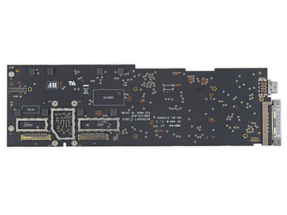

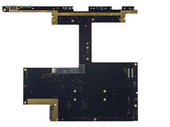

  9. Microsoft Surface Book Teardown: crwdns2935265:09crwdnd2935265:01crwdnd2935265:03crwdne2935265:0 Microsoft Surface Book Teardown: crwdns2935265:09crwdnd2935265:02crwdnd2935265:03crwdne2935265:0 Microsoft Surface Book Teardown: crwdns2935265:09crwdnd2935265:03crwdnd2935265:03crwdne2935265:0
    • Peeling up a thin foam layer confirms our suspicions—the motherboard is indeed upside down—smooth back up top, connectors and chips on the bottom.
    • Our best bet about why this happened is that Microsoft wanted a smooth backing to support the large and rather flexible display.
    • Surprisingly, said motherboard also sprawls throughout the entire chassis, resembling some kind of nightmarish Tetris piece.
    • What's more, there's no sign of connectors for any of the peripheral components.
    • At least the camera bar comes up without any trouble. Maybe we'll find some tasty treasure below.

  12. Microsoft Surface Book Teardown: crwdns2935265:012crwdnd2935265:01crwdnd2935265:02crwdne2935265:0 Microsoft Surface Book Teardown: crwdns2935265:012crwdnd2935265:02crwdnd2935265:02crwdne2935265:0
    • Some finagling frees the speaker connectors, allowing us to lift and remove the nightmare of a motherboard assembly.
    • This is a motherboard only a mother could love...

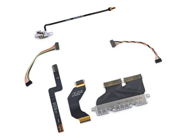

  13. Microsoft Surface Book Teardown: crwdns2935265:013crwdnd2935265:01crwdnd2935265:02crwdne2935265:0 Microsoft Surface Book Teardown: crwdns2935265:013crwdnd2935265:02crwdnd2935265:02crwdne2935265:0
    • Prepping the motherboard for its glamor shot, we begin the arduous task of removing cables. Soo many cables.
    • Modular construction means that replacing any particular interconnect cable will be cheaper, but a (more common) motherboard replacement will be a bit time-consuming.

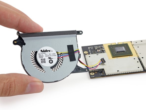

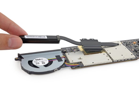

  14. Microsoft Surface Book Teardown: crwdns2935265:014crwdnd2935265:01crwdnd2935265:03crwdne2935265:0 Microsoft Surface Book Teardown: crwdns2935265:014crwdnd2935265:02crwdnd2935265:03crwdne2935265:0 Microsoft Surface Book Teardown: crwdns2935265:014crwdnd2935265:03crwdnd2935265:03crwdne2935265:0
    • With the motherboard sunny side up, we take a moment to pull out its brushless, 0.5 Amp fan.
    • Eager to get a taste of that sweet, sweet silicon, we also relieve the motherboard of its sprawling heat sink.
    • The cooling system in the Surface Book bears a passing resemblance to the large copper plate tucked against the battery of the Surface Pro 4, but covers silicon instead of Li-ion.
    • The display features a single oversized heat pipe, forming the top of a duct that uses the fan to pull heat away from the processor and major on-board components.

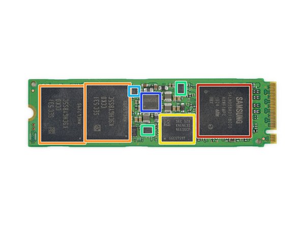

  16. Microsoft Surface Book Teardown: crwdns2935265:016crwdnd2935265:01crwdnd2935265:03crwdne2935265:0 Microsoft Surface Book Teardown: crwdns2935265:016crwdnd2935265:02crwdnd2935265:03crwdne2935265:0 Microsoft Surface Book Teardown: crwdns2935265:016crwdnd2935265:03crwdnd2935265:03crwdne2935265:0
    • We're on the home stretch—all that stands between us and total motherboard liberation is the 128 GB Samsung PM951 SSD.
    • This memory module is giving us feelings of déjà vu—it's identical to the one we found in the Surface Pro 4 (although, unlike in the Pro, this aluminum SSD tray is literally just taped to the back of the motherboard):
    • Samsung S4LN058A01-8030 PCIe 3.0 x4 NVMe flash controller
    • Samsung K9CHGY8S5C-CCK0 64 GB NAND Flash
    • Samsung K4E4E324EE-SGCF 4 Gb (512 MB) DRAM
    • Texas Instruments TPS22966 5.5V, 6A, 16mΩ, 2-Channel Load Switch
    • Texas Instruments TPS22965 5.7 V, 6 A Load Switch
    • Silergy Power Management (likely)
  17. Microsoft Surface Book Teardown: crwdns2935265:017crwdnd2935265:01crwdnd2935265:01crwdne2935265:0
    • Finally a bare logic—err, motherboard. That black PCB à la Steve Jobs had us confused for a second.
    • Intel SR2F0 Core i5-6300U Processor (3M Cache, up to 3.00 GHz)
    • Samsung K4E6E304EE-EGCF 16 Gb LPDDR3 1867 MHz SDRAM (4 chips for a total of 8 GB)
    • Marvell Avastar W8897, likely Wi-Fi/Bluetooth combo chip
    • Freescale Kinetis KL17 MKL17Z256VFM4 48 MHz ARM Cortex-M0+ microcontroller
    • Realtek ALC3269 Audio Codec
    • Infineon Technologies SLB9665TT20 Trusted Platform Module
    • Intersil ISL95857 1+2+1 Voltage Regulator for Intel IMVP8 CPUs

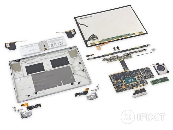

  23. Microsoft Surface Book Teardown: crwdns2935265:023crwdnd2935265:01crwdnd2935265:01crwdne2935265:0
    • Cue the intermission music! We're halfway through this Book, but we can hardly wait for chapter two!
    • Enjoy this initial layout, but the base-t is yet to come!
    • The best... the base... You get it? Yeah?

    • First out of this tiny MacBook base is an SD reader, blocking access to the I/O board.
    • Well, that and a nest of cables.
    • At last the board is free. Here's what it's packing:
    • Freescale SC667334DC (maybe a custom microcontroller)
    • Realtek RTS5314 SD card reader controller
    • Winbond W25X40CLIG serial flash memory
    • Genesys Logic GL3520 USB 3.1 hub controller
    • Texas Instruments TPS75105 LED driver

    • Appetite whetted, we pluck out the Book's GPU board assembly and its attached fan.
    • We find a suspiciously Mac-like heat sink mounted to the base's GPU.
    • Wow, this is really giving off an Apple vibe.
    • We've always said we could use a few more fans. With the heat sink out of the picture, the base's 0.30 Amp model is ours for the taking.
    • That would have been a lot of work just to clean a dusty fan. Let's hope that never happens.

    • Now it's time to get twisted and unhinged.
    • We spin a handy Torx precision driver to free the segmented hinge from the base.
    • The cables slide free of their basic home fairly easily, but then disappear into the spine of the hinge...
    • The segments are secured with various screws, so hinge, spine, and cables are likely replaceable, should they wear out.

    • All your base are belong to us. But don't worry you get a cool layout out of it!
    • The Microsoft Surface Book (as a whole) earns a reparability score of 1 out of 10 (10 is easiest to repair).
    • After the difficult opening procedure, the SSD can be replaced. So too the glued battery in the display. However, the base battery is very heavily glued.
    • The display assembly consists of a fused glass panel and LCD, and is difficult to remove and replace.
    • The processor and RAM are soldered to the motherboard.
    • Strong adhesive holds many components in place, including the display, base cover, and both batteries.
    • Many components are on the backs of their respective boards, requiring motherboard removal to replace simple components.
