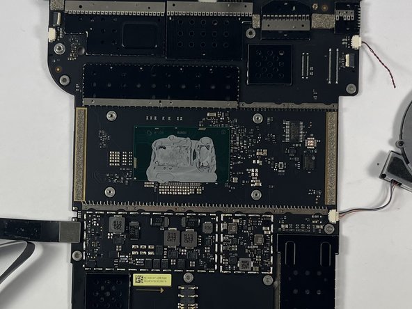

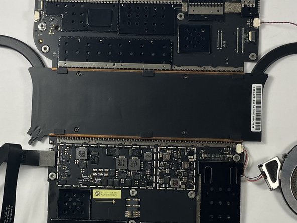

  8. Microsoft Surface Book 2 15" Heat Sink Replacement, Heat Sink: crwdns2935265:08crwdnd2935265:01crwdnd2935265:02crwdne2935265:0 Microsoft Surface Book 2 15" Heat Sink Replacement, Heat Sink: crwdns2935265:08crwdnd2935265:02crwdnd2935265:02crwdne2935265:0
    • With the motherboard removed flip it over.
  9. Microsoft Surface Book 2 15" Heat Sink Replacement: crwdns2935265:09crwdnd2935265:01crwdnd2935265:02crwdne2935265:0 Microsoft Surface Book 2 15" Heat Sink Replacement: crwdns2935265:09crwdnd2935265:02crwdnd2935265:02crwdne2935265:0
    • Remove the 4 torx 3 2.5mm screws holding in the heatsink.
    • Lift up and remove the heatsink. This requires a small amount of force.
