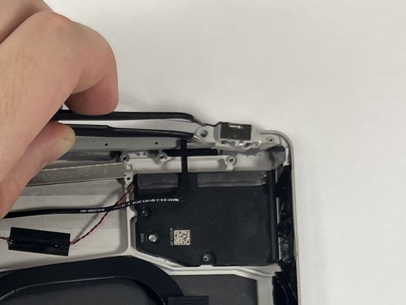

  8. Microsoft Surface Book 2 15" Headphone Jack Replacement, Headphone Jack: crwdns2935265:08crwdnd2935265:01crwdnd2935265:02crwdne2935265:0 Microsoft Surface Book 2 15" Headphone Jack Replacement, Headphone Jack: crwdns2935265:08crwdnd2935265:02crwdnd2935265:02crwdne2935265:0
    • Gently pull the headphone jack out of the slot.

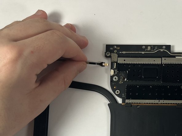

  9. Microsoft Surface Book 2 15" Headphone Jack Replacement: crwdns2935265:09crwdnd2935265:01crwdnd2935265:02crwdne2935265:0 Microsoft Surface Book 2 15" Headphone Jack Replacement: crwdns2935265:09crwdnd2935265:02crwdnd2935265:02crwdne2935265:0
    • On the motherboard, unplug the ribbon cable connecting the headphone jack to the motherboard.
    • Flip up the latch on the connector and then pull out the cable.
