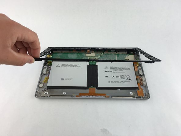

  3. Microsoft Surface 2 Speaker Replacement, Speaker: crwdns2935265:03crwdnd2935265:01crwdnd2935265:02crwdne2935265:0 Microsoft Surface 2 Speaker Replacement, Speaker: crwdns2935265:03crwdnd2935265:02crwdnd2935265:02crwdne2935265:0
    • Work close to Magnetic Project Map to avoid losing screws.
    • Remove ten 3.45 mm T3 screws from the corners of the black plastic bezel.
    • Remove the remaining seventeen 4.4 mm T5 screws from the perimeter of the bezel.
    • Once all screws have been removed, lift and remove the bezel from the rest of the device.

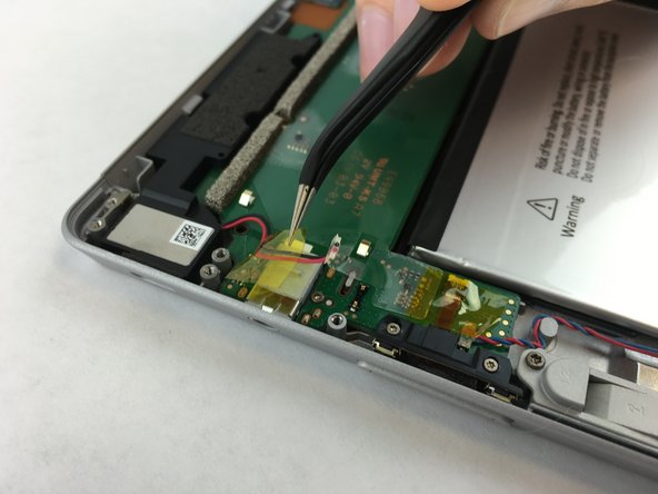

  5. Microsoft Surface 2 Speaker Replacement: crwdns2935265:05crwdnd2935265:01crwdnd2935265:02crwdne2935265:0 Microsoft Surface 2 Speaker Replacement: crwdns2935265:05crwdnd2935265:02crwdnd2935265:02crwdne2935265:0
    • Using tweezers, remove the cable connecting the speaker to the motherboard.
    • Peel up the tiny strip of yellow tape securing the cable to the motherboard.

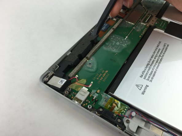

  6. Microsoft Surface 2 Speaker Replacement: crwdns2935265:06crwdnd2935265:01crwdnd2935265:02crwdne2935265:0 Microsoft Surface 2 Speaker Replacement: crwdns2935265:06crwdnd2935265:02crwdnd2935265:02crwdne2935265:0
    • Lifting from the inmost end of the speaker, use a spudger to carefully pry the speaker from the motherboard.
