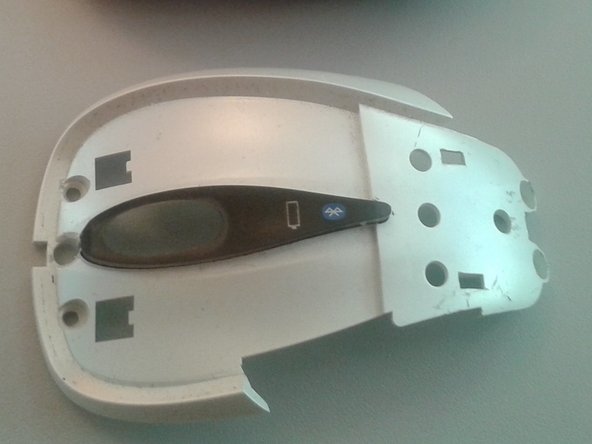

  3. Microsoft Bluetooth Notebook Mouse 5000 Central wheel button switch Fix, Remove the gray plastic lid: crwdns2935265:03crwdnd2935265:01crwdnd2935265:02crwdne2935265:0 Microsoft Bluetooth Notebook Mouse 5000 Central wheel button switch Fix, Remove the gray plastic lid: crwdns2935265:03crwdnd2935265:02crwdnd2935265:02crwdne2935265:0
    • This is a tricky one, you can easily now lift the lid from where I pointed out
    • After this you have to "unclick" the front of the lid, gently lifting from down to up, nothing will break
    • As you see in the next image the lid has a "clip" that clips on the base

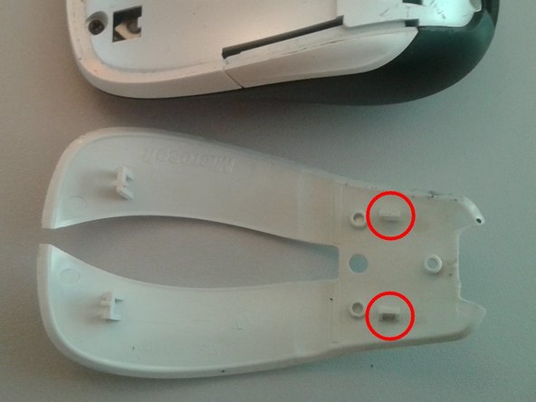

  4. Microsoft Bluetooth Notebook Mouse 5000 Central wheel button switch Fix, Remove the white plastic left & right buttons: crwdns2935265:04crwdnd2935265:01crwdnd2935265:02crwdne2935265:0 Microsoft Bluetooth Notebook Mouse 5000 Central wheel button switch Fix, Remove the white plastic left & right buttons: crwdns2935265:04crwdnd2935265:02crwdnd2935265:02crwdne2935265:0
    • You have to carefully unclick both left and right the plastic lid with buttons, acting with your nails under the lid
    • It's easy to insert your nails starting from the button side to the left in this image, and then shifting to the right
    • You'll clearly hear the "click" when the tab loose: simply do it on the other side, and raise the whole thing up
    • You can see the two tabs of the buttons in the second picture of this step

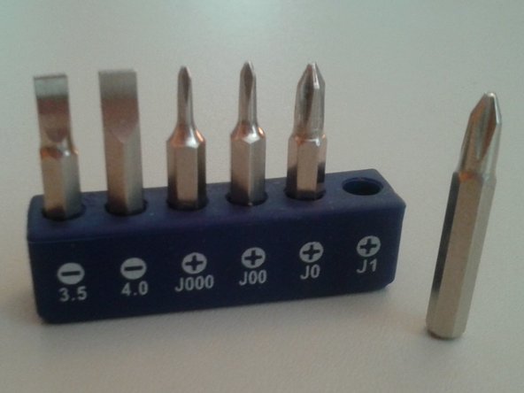

  5. Microsoft Bluetooth Notebook Mouse 5000 Central wheel button switch Fix, Unscrew the 4 J1 screws: crwdns2935265:05crwdnd2935265:01crwdnd2935265:03crwdne2935265:0 Microsoft Bluetooth Notebook Mouse 5000 Central wheel button switch Fix, Unscrew the 4 J1 screws: crwdns2935265:05crwdnd2935265:02crwdnd2935265:03crwdne2935265:0 Microsoft Bluetooth Notebook Mouse 5000 Central wheel button switch Fix, Unscrew the 4 J1 screws: crwdns2935265:05crwdnd2935265:03crwdnd2935265:03crwdne2935265:0
    • Unscrew the four black J1 screws showed in the pic
    • You'll need a J1 bit like the iFixi one I used here

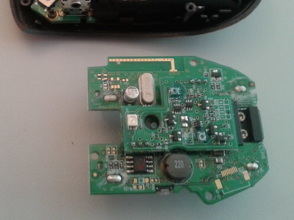

  7. Microsoft Bluetooth Notebook Mouse 5000 Central wheel button switch Fix, Remove the main circuit board: crwdns2935265:07crwdnd2935265:01crwdnd2935265:02crwdne2935265:0 Microsoft Bluetooth Notebook Mouse 5000 Central wheel button switch Fix, Remove the main circuit board: crwdns2935265:07crwdnd2935265:02crwdnd2935265:02crwdne2935265:0
    • Unscrew the three J1 black screws showed in the pic
    • Gently lift up the circuit board
    • You have to be careful reinserting: both the four battery connectors, and the multi plug should go in the right places: nothing difficult!

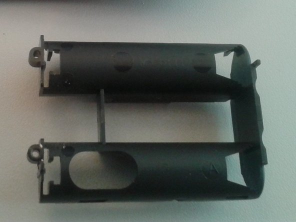

  8. Microsoft Bluetooth Notebook Mouse 5000 Central wheel button switch Fix, Remove the battery compartment: crwdns2935265:08crwdnd2935265:01crwdnd2935265:02crwdne2935265:0 Microsoft Bluetooth Notebook Mouse 5000 Central wheel button switch Fix, Remove the battery compartment: crwdns2935265:08crwdnd2935265:02crwdnd2935265:02crwdne2935265:0
    • Unclick the plastic in the four point showed up
    • It's easy, once unclicked the tabs stay put, no need to hassle
    • Gently lify up and put aside. Reassembling be careful to bring out the light plastic battery guides from down

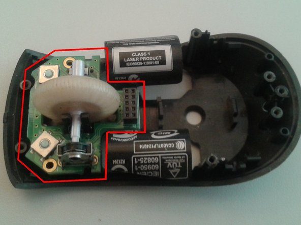

  10. Microsoft Bluetooth Notebook Mouse 5000 Central wheel button switch Fix, Fix the microswitch: crwdns2935265:010crwdnd2935265:01crwdnd2935265:02crwdne2935265:0 Microsoft Bluetooth Notebook Mouse 5000 Central wheel button switch Fix, Fix the microswitch: crwdns2935265:010crwdnd2935265:02crwdnd2935265:02crwdne2935265:0
    • Lift up the wheel gently from the side shown in the pic
    • You can use this opportunity to deep clean the wheel, and the area
    • You can see the central wheel button microswitch in the second pic
    • In my case just cleaning with blowing air the switch worked! If needed you can now substitute any defective switch
    • To change the switches with new one you need the appropriate tools, and a discrete ability with soldering!!
    • To reassemble the mouse just follow the steps in reverse order
