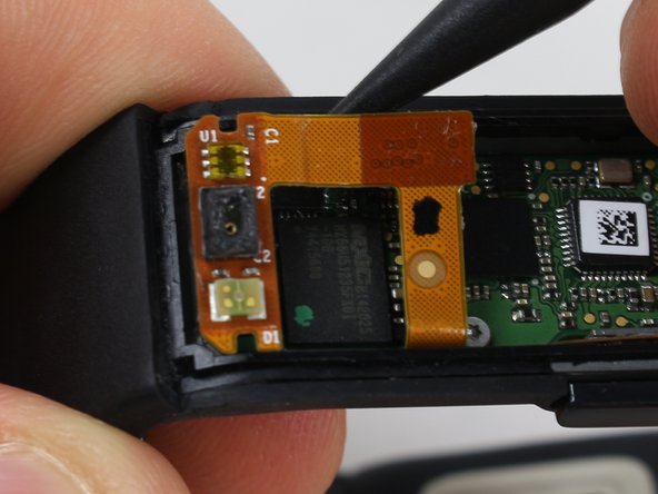

    1. Microsoft Band Sensor Ribbon Replacement, Sensor Ribbon: crwdns2935265:06crwdnd2935265:01crwdnd2935265:02crwdne2935265:0 Microsoft Band Sensor Ribbon Replacement, Sensor Ribbon: crwdns2935265:06crwdnd2935265:02crwdnd2935265:02crwdne2935265:0
      • Handle the ribbon with care to prevent damage. Do not bend the ribbon unless specified.
      • Using the spudger or the plastic opening tool, gently unhook the golden ribbon from the corner on the opposite side of the buttons. The part of the ribbon with the three boxes should then easily be detached from the band.
    2. Microsoft Band Sensor Ribbon Replacement: crwdns2935265:07crwdnd2935265:01crwdnd2935265:01crwdne2935265:0
      • Using your fingers or tweezers, gently pull the band from away from the motherboard to detach the strip from the buttons.
