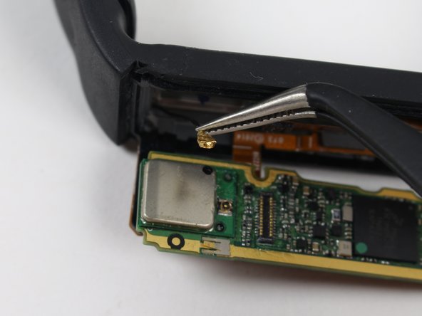

  7. Microsoft Band Motherboard Replacement: crwdns2935265:07crwdnd2935265:01crwdnd2935265:02crwdne2935265:0 Microsoft Band Motherboard Replacement: crwdns2935265:07crwdnd2935265:02crwdnd2935265:02crwdne2935265:0
    • Using the spudger or the tweezers, gently detach the golden connector from the motherboard.

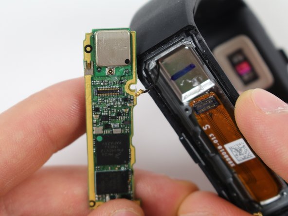

  9. Microsoft Band Motherboard Replacement: crwdns2935265:09crwdnd2935265:01crwdnd2935265:01crwdne2935265:0
    • Be gentle. Make sure not to rip apart the cord underneath that connects the heart-rate monitor to the motherboard.
    • Using the spudger and your fingers, gently lift the motherboard from the band socket.
    • You should feel a "pop."

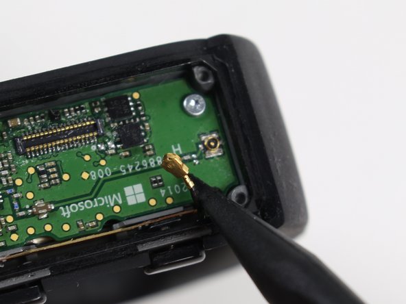

  10. Microsoft Band Motherboard Replacement: crwdns2935265:010crwdnd2935265:01crwdnd2935265:03crwdne2935265:0 Microsoft Band Motherboard Replacement: crwdns2935265:010crwdnd2935265:02crwdnd2935265:03crwdne2935265:0 Microsoft Band Motherboard Replacement: crwdns2935265:010crwdnd2935265:03crwdnd2935265:03crwdne2935265:0
    • Gently flip the motherboard so that you are viewing the motherboard from underneath.
    • Using the tweezers, gently detach the golden connector from the back of the motherboard.
