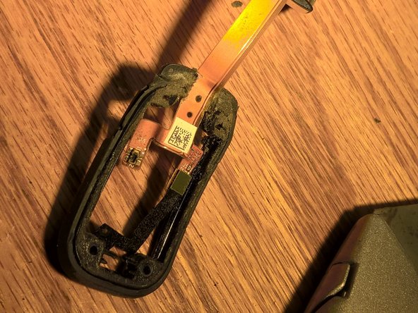

      • Partly dissassemble the battery clasp end: pry up the silver clasp face that is taped down, unscrew the four T3 Torx , remove that cover, remove the battery
    3. Microsoft Band 2 Defective Battery Connection/Ribbon Replacement: crwdns2935265:03crwdnd2935265:01crwdnd2935265:02crwdne2935265:0 Microsoft Band 2 Defective Battery Connection/Ribbon Replacement: crwdns2935265:03crwdnd2935265:02crwdnd2935265:02crwdne2935265:0
      • Remove the plastic 'sandwiching' the ribbon as it travels into the clasp end, with a Dremel or knife. (Picture 2 illustrates the removed plastic.)

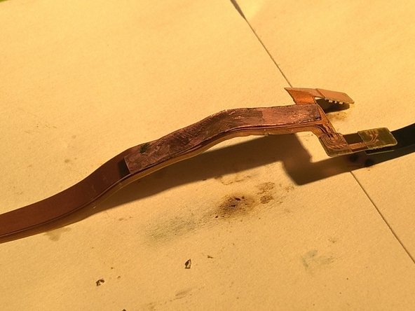

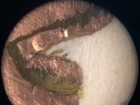

      • Sand the ribbon to expose the conductors on both sides. Be careful to keep the insulator in between the two conductors intact, so they don't short. The second picture shows a 10x image of the layers of copper and insulator.

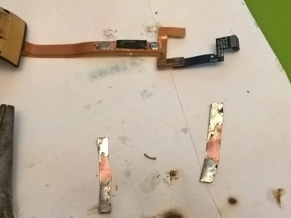

      • Wrap the repaired break with insulating tape. Sand away outer insulator on both sides to make soldering locations for jumper strips.

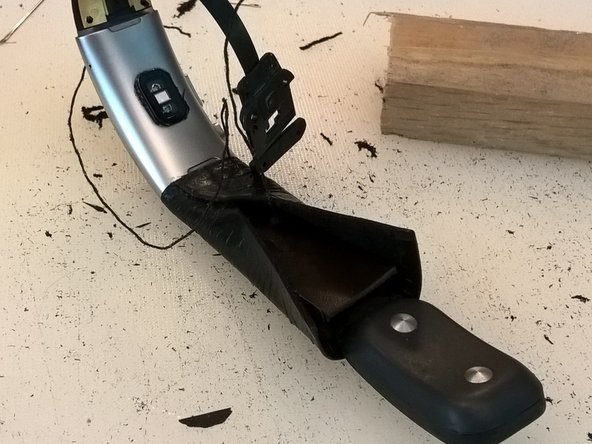

      • Use Sugru to wrap/stabilize the repair and integrate it into the clasp end's rubber.

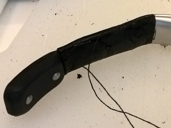

    8. Microsoft Band 2 Defective Battery Connection/Ribbon Replacement: crwdns2935265:08crwdnd2935265:01crwdnd2935265:03crwdne2935265:0 Microsoft Band 2 Defective Battery Connection/Ribbon Replacement: crwdns2935265:08crwdnd2935265:02crwdnd2935265:03crwdne2935265:0 Microsoft Band 2 Defective Battery Connection/Ribbon Replacement: crwdns2935265:08crwdnd2935265:03crwdnd2935265:03crwdne2935265:0
      • Build new leather straps; fasten using thread through holes & glue.
Your Band 2 should (!) hold a charge now. Not sure how durable this repair is.
