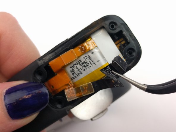

  4. Microsoft Band 2 Battery Replacement: crwdns2935265:04crwdnd2935265:01crwdnd2935265:02crwdne2935265:0 Microsoft Band 2 Battery Replacement: crwdns2935265:04crwdnd2935265:02crwdnd2935265:02crwdne2935265:0
    • Detach the black ribbon cable by using the tweezers.
  5. Microsoft Band 2 Battery Replacement: crwdns2935265:05crwdnd2935265:01crwdnd2935265:02crwdne2935265:0 Microsoft Band 2 Battery Replacement: crwdns2935265:05crwdnd2935265:02crwdnd2935265:02crwdne2935265:0
    • Detach the orange press-fit (or "pop") connector by using the tweezers.

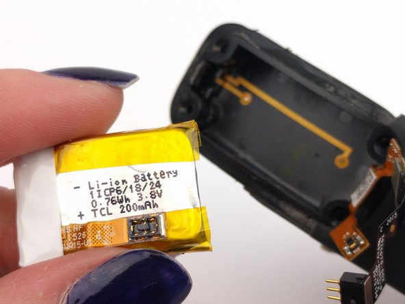

  6. Microsoft Band 2 Battery Replacement: crwdns2935265:06crwdnd2935265:01crwdnd2935265:02crwdne2935265:0 Microsoft Band 2 Battery Replacement: crwdns2935265:06crwdnd2935265:02crwdnd2935265:02crwdne2935265:0
    • Pry out the battery using the plastic opening tool.

Batteries can be found on ebay. I was surprised to see the band come back to life. I found the “pop” connector difficult to align properly. Almost lost patience with it. Got it on, reassembled and it powered up.
