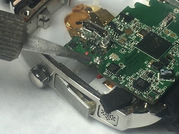

    1. Micro-USB Port Replacement, Micro-USB Port: crwdns2935265:010crwdnd2935265:01crwdnd2935265:01crwdne2935265:0
      • Locate the four main soldering points marked in red.
      • Be aware of the five additional soldered pins marked by the blue arrow.

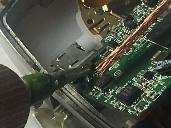

    2. Micro-USB Port Replacement: crwdns2935265:011crwdnd2935265:01crwdnd2935265:03crwdne2935265:0 Micro-USB Port Replacement: crwdns2935265:011crwdnd2935265:02crwdnd2935265:03crwdne2935265:0 Micro-USB Port Replacement: crwdns2935265:011crwdnd2935265:03crwdnd2935265:03crwdne2935265:0
      • Begin to desolder the points pointed out in the last step.
      • Use the soldering wick to help remove the solder.
