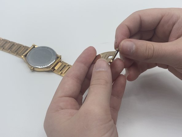

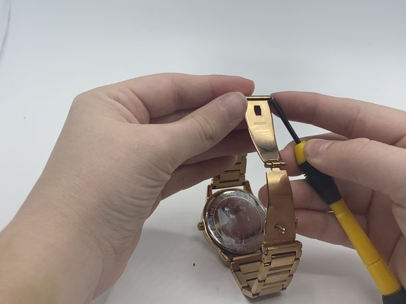

  2. Michael Kors Hartman Rose Gold Watch Battery Replacement: crwdns2935265:02crwdnd2935265:01crwdnd2935265:03crwdne2935265:0 Michael Kors Hartman Rose Gold Watch Battery Replacement: crwdns2935265:02crwdnd2935265:02crwdnd2935265:03crwdne2935265:0 Michael Kors Hartman Rose Gold Watch Battery Replacement: crwdns2935265:02crwdnd2935265:03crwdnd2935265:03crwdne2935265:0
    • Locate the spring pin under the band strap with the latch hole.
    • Insert a push-pin into the hole.
    • Push against the spring pin as needed until the band strap pops out.
    • Remove the spring pin.
    • Be sure to place the spring pin in a safe location. You will need it later for reassembling the watch.

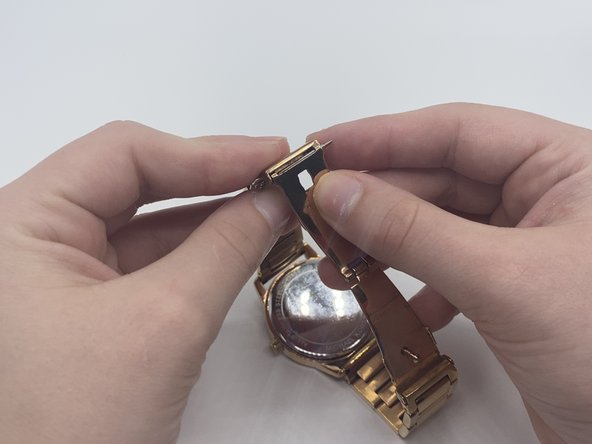

  11. Michael Kors Hartman Rose Gold Watch Battery Replacement: crwdns2935265:011crwdnd2935265:01crwdnd2935265:03crwdne2935265:0 Michael Kors Hartman Rose Gold Watch Battery Replacement: crwdns2935265:011crwdnd2935265:02crwdnd2935265:03crwdne2935265:0 Michael Kors Hartman Rose Gold Watch Battery Replacement: crwdns2935265:011crwdnd2935265:03crwdnd2935265:03crwdne2935265:0
    • Re-insert the pin you removed into the hole of the smaller (lengthwise) folding segment.
  12. Michael Kors Hartman Rose Gold Watch Battery Replacement: crwdns2935265:012crwdnd2935265:01crwdnd2935265:02crwdne2935265:0 Michael Kors Hartman Rose Gold Watch Battery Replacement: crwdns2935265:012crwdnd2935265:02crwdnd2935265:02crwdne2935265:0
    • Align both ends of the watch, holding the segment with the spring pin adjacent to the hole.
  13. Michael Kors Hartman Rose Gold Watch Battery Replacement: crwdns2935265:013crwdnd2935265:01crwdnd2935265:03crwdne2935265:0 Michael Kors Hartman Rose Gold Watch Battery Replacement: crwdns2935265:013crwdnd2935265:02crwdnd2935265:03crwdne2935265:0 Michael Kors Hartman Rose Gold Watch Battery Replacement: crwdns2935265:013crwdnd2935265:03crwdnd2935265:03crwdne2935265:0
    • Use a spudger to press down on the spring pin, guiding it into the second hole.
    • Release once connecting segments are in place.
  14. Michael Kors Hartman Rose Gold Watch Battery Replacement: crwdns2935265:014crwdnd2935265:01crwdnd2935265:03crwdne2935265:0 Michael Kors Hartman Rose Gold Watch Battery Replacement: crwdns2935265:014crwdnd2935265:02crwdnd2935265:03crwdne2935265:0 Michael Kors Hartman Rose Gold Watch Battery Replacement: crwdns2935265:014crwdnd2935265:03crwdnd2935265:03crwdne2935265:0
    • Optional: Use your electronic wipes to remove any unwanted fingerprints.
    • Place your wrist in the watch.
    • Relatch to ensure you correctly reassembled the watch.
