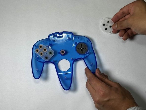

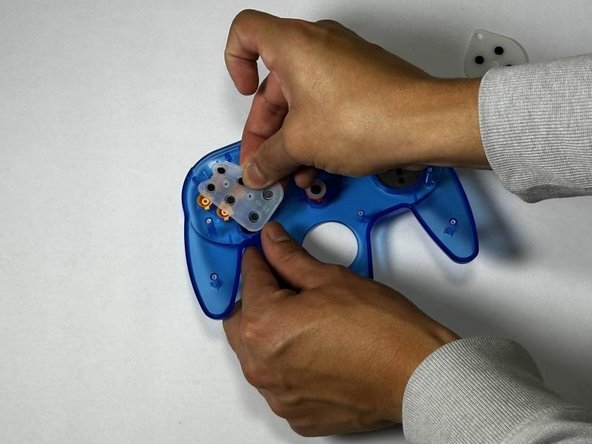

  7. Miadore Classic N64 Controller Buttons Replacement: crwdns2935265:07crwdnd2935265:01crwdnd2935265:03crwdne2935265:0 Miadore Classic N64 Controller Buttons Replacement: crwdns2935265:07crwdnd2935265:02crwdnd2935265:03crwdne2935265:0 Miadore Classic N64 Controller Buttons Replacement: crwdns2935265:07crwdnd2935265:03crwdnd2935265:03crwdne2935265:0
    • Remove the rubber gaskets.
    • This will reveal the buttons underneath.
  8. Miadore Classic N64 Controller Buttons Replacement: crwdns2935265:08crwdnd2935265:01crwdnd2935265:02crwdne2935265:0 Miadore Classic N64 Controller Buttons Replacement: crwdns2935265:08crwdnd2935265:02crwdnd2935265:02crwdne2935265:0
    • Push up from the bottom of the controller to pop the buttons out.
