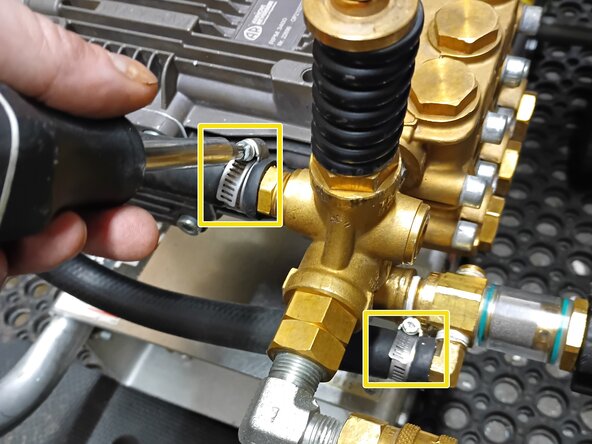

    • First, identify the Unloader(1), Handle(2), and Unloader Hose(3).
    • Then, with a phillips screw driver, Undo the 2 screws, BUT NOT ALL OF THE WAY! Unscrewing will release tension on the hose and allow you to slide the clamp down the hose for hose removal.
    • Pull firmly, while shaking sideways and up and down to pull hose off. NEVER PULL STRAIGHT OFF! Can cause tearing/ripping/leaking. If you hear something that sounds similar to the rubber hose ripping or tearing, get a small flat head screw driver and *VERY* gently pry end open while other hand shakes and pulls on hose.

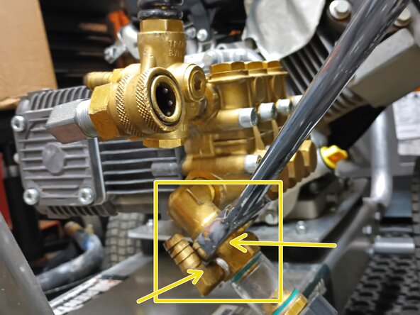

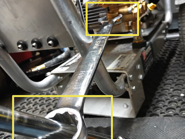

    • Now that the hose is off. Take your 1 & 1/8th's wrench and place it on the back of the Angled piece as seen circled in the 1st picture. Rotate Clockwise to tighten it, this will bring the spout/filter down, its best to get it AS CLOSE TO THE FRAME AS POSSIBLE! All of the way down so that the side spigot doesn't snag when unscrewing.
    • Once the Spout/water filter is facing as far down as it can, Begin by taking your 1 & 1/8th Wrench and unscrew the water filter off, at its base.
    • If you need to, I found it was easier to put the wrench under the side spigot/spout that's on the water filter spout. (see 2nd picture)
    • After the Water filter spout has been removed, go ahead and use the same wrench to remove the Angled piece that the water filter was connected to. It may be very difficult. What i did was, I placed the wrench, and then used a socket wrench extender to give leverage so i can rotate until i can rotate by hand. (see 3rd picture)

    • Place the backside of your 1 & 1/8th wrench (the circle part) on top of the Unloader as seen in the picture. It will fit snug on top of the handle itself, not risking any damage to the unloader itself. Rotate counter clockwise until removed.
    • Follow steps in reverse for Reassembly.
