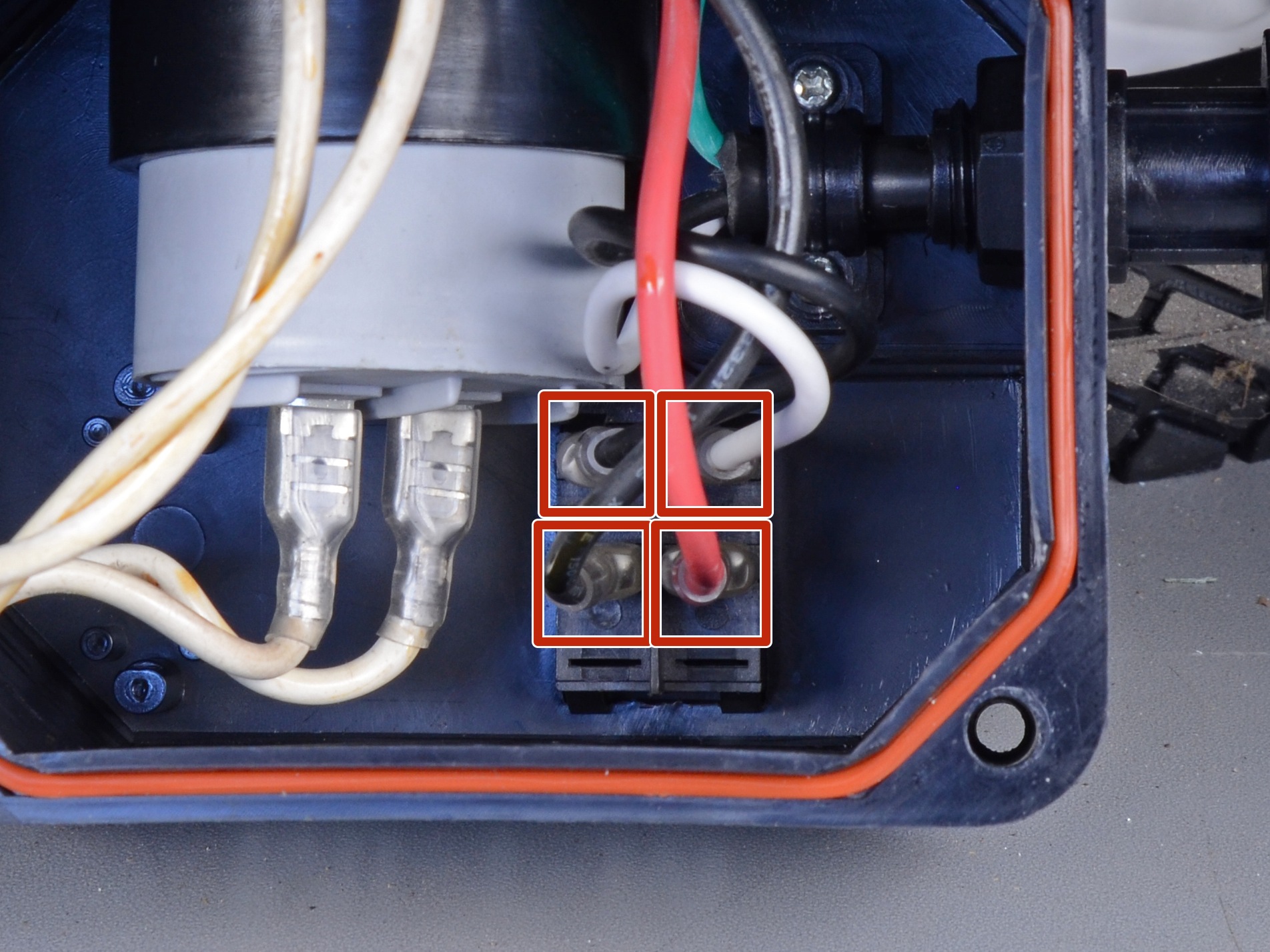

  4. MiTM Pressure Washer CM1400HDEC1 2017 Power Switch Replacement, Disconnect the wires attached to the power switch: crwdns2935265:04crwdnd2935265:01crwdnd2935265:03crwdne2935265:0 MiTM Pressure Washer CM1400HDEC1 2017 Power Switch Replacement, Disconnect the wires attached to the power switch: crwdns2935265:04crwdnd2935265:02crwdnd2935265:03crwdne2935265:0 MiTM Pressure Washer CM1400HDEC1 2017 Power Switch Replacement, Disconnect the wires attached to the power switch: crwdns2935265:04crwdnd2935265:03crwdnd2935265:03crwdne2935265:0
    • Disconnect the four wires running to the backside of the power switch.
    • These wires may be difficult to remove. If necessary, you can use a pair of pliers to gently pull them up off their contact rails.
