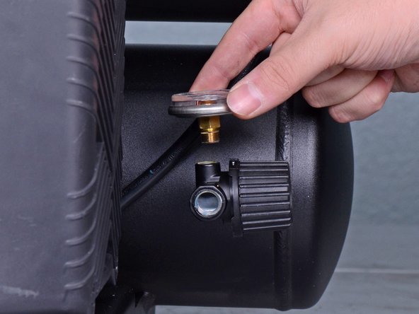

    • Before you begin, ensure the device is powered down and cool to the touch.
    • Ensure the compressor is unplugged.
    • Flip the pressure switch lever up to the off position.
  2. MiTM Air Compressors AM1HE0205HD 2014 Regulator Replacement, Drain the air from the compressor: crwdns2935265:02crwdnd2935265:01crwdnd2935265:02crwdne2935265:0 MiTM Air Compressors AM1HE0205HD 2014 Regulator Replacement, Drain the air from the compressor: crwdns2935265:02crwdnd2935265:02crwdnd2935265:02crwdne2935265:0
    • Pull the ring on the safety release valve away from the compressor tank to drain the air from the compressor.
    • Ensure all air is drained from the tank before beginning repairs.

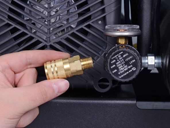

  3. MiTM Air Compressors AM1HE0205HD 2014 Regulator Replacement, Remove the air hose quick-connect socket: crwdns2935265:03crwdnd2935265:01crwdnd2935265:02crwdne2935265:0 MiTM Air Compressors AM1HE0205HD 2014 Regulator Replacement, Remove the air hose quick-connect socket: crwdns2935265:03crwdnd2935265:02crwdnd2935265:02crwdne2935265:0
    • Use a 3/4 inch wrench to loosen and remove the air hose quick-connect socket.
  4. MiTM Air Compressors AM1HE0205HD 2014 Regulator Replacement, Remove the pressure gauge: crwdns2935265:04crwdnd2935265:01crwdnd2935265:02crwdne2935265:0 MiTM Air Compressors AM1HE0205HD 2014 Regulator Replacement, Remove the pressure gauge: crwdns2935265:04crwdnd2935265:02crwdnd2935265:02crwdne2935265:0
    • Use a 7/16 inch wrench to loosen and remove the pressure gauge.

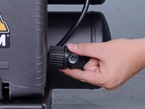

  5. MiTM Air Compressors AM1HE0205HD 2014 Regulator Replacement, Remove the regulator: crwdns2935265:05crwdnd2935265:01crwdnd2935265:01crwdne2935265:0
    • Use a 5/8" wrench to loosen the air tank nipple from the air tank enough to be able to rotate it with the regulator.

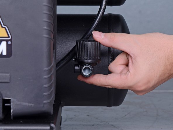

  6. MiTM Air Compressors AM1HE0205HD 2014 Regulator Replacement: crwdns2935265:06crwdnd2935265:01crwdnd2935265:03crwdne2935265:0 MiTM Air Compressors AM1HE0205HD 2014 Regulator Replacement: crwdns2935265:06crwdnd2935265:02crwdnd2935265:03crwdne2935265:0 MiTM Air Compressors AM1HE0205HD 2014 Regulator Replacement: crwdns2935265:06crwdnd2935265:03crwdnd2935265:03crwdne2935265:0
    • Rotate the regulator 180°, so the bottom of the regulator faces away from the compressor motor.

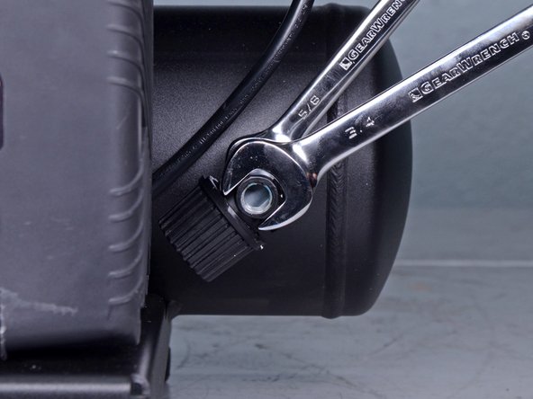

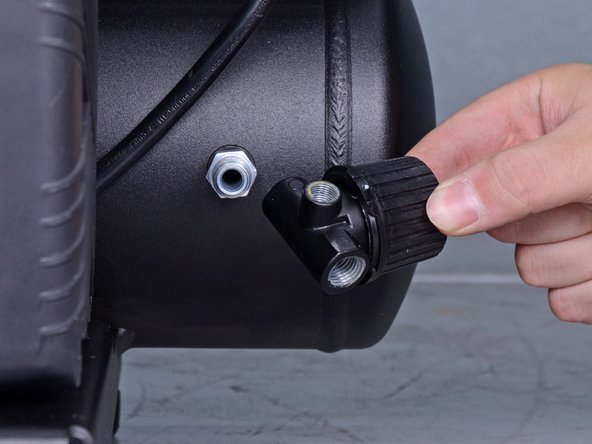

  7. MiTM Air Compressors AM1HE0205HD 2014 Regulator Replacement: crwdns2935265:07crwdnd2935265:01crwdnd2935265:03crwdne2935265:0 MiTM Air Compressors AM1HE0205HD 2014 Regulator Replacement: crwdns2935265:07crwdnd2935265:02crwdnd2935265:03crwdne2935265:0 MiTM Air Compressors AM1HE0205HD 2014 Regulator Replacement: crwdns2935265:07crwdnd2935265:03crwdnd2935265:03crwdne2935265:0
    • With a 5/8 inch wrench bracing the air tank nipple, use a 3/4 inch wrench to loosen and remove the regulator.
    • Make sure the nipple stays connected to the air tank.
    • During reassembly, tighten the air tank nipple to the air tank, and then tighten the regulator to the nipple.
