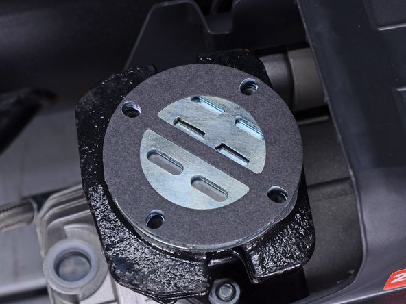

  5. MiTM Air Compressors AM1HE0205HD 2014 Pump Gaskets Replacement, Remove the upper valve plate: crwdns2935265:05crwdnd2935265:01crwdnd2935265:02crwdne2935265:0 MiTM Air Compressors AM1HE0205HD 2014 Pump Gaskets Replacement, Remove the upper valve plate: crwdns2935265:05crwdnd2935265:02crwdnd2935265:02crwdne2935265:0
    • Remove the upper valve plate.
    • Take care not to lose the small rectangular valves sitting on the plates.
  6. MiTM Air Compressors AM1HE0205HD 2014 Pump Gaskets Replacement, Remove the pump head gasket: crwdns2935265:06crwdnd2935265:01crwdnd2935265:02crwdne2935265:0 MiTM Air Compressors AM1HE0205HD 2014 Pump Gaskets Replacement, Remove the pump head gasket: crwdns2935265:06crwdnd2935265:02crwdnd2935265:02crwdne2935265:0
    • Peel the pump head gasket off of the upper valve plate.
    • The pump head gasket may have stuck to the bottom of the pump head. If this is the case, remove it from the pump head.
  7. MiTM Air Compressors AM1HE0205HD 2014 Pump Gaskets Replacement, Remove the lower valve plate: crwdns2935265:07crwdnd2935265:01crwdnd2935265:02crwdne2935265:0 MiTM Air Compressors AM1HE0205HD 2014 Pump Gaskets Replacement, Remove the lower valve plate: crwdns2935265:07crwdnd2935265:02crwdnd2935265:02crwdne2935265:0
    • Remove the lower valve plate.

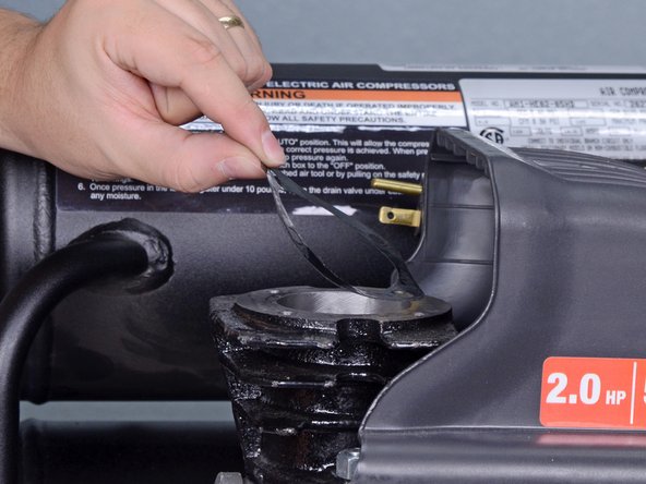

  8. MiTM Air Compressors AM1HE0205HD 2014 Pump Gaskets Replacement, Remove the valve plate gasket: crwdns2935265:08crwdnd2935265:01crwdnd2935265:01crwdne2935265:0
    • Remove the valve plate gasket from the lower valve plate.
    • The valve plate gasket may have stuck to the bottom of the upper valve plate. If this is the case, remove it from the upper valve plate.
  9. MiTM Air Compressors AM1HE0205HD 2014 Pump Gaskets Replacement, Remove the cylinder gasket: crwdns2935265:09crwdnd2935265:01crwdnd2935265:03crwdne2935265:0 MiTM Air Compressors AM1HE0205HD 2014 Pump Gaskets Replacement, Remove the cylinder gasket: crwdns2935265:09crwdnd2935265:02crwdnd2935265:03crwdne2935265:0 MiTM Air Compressors AM1HE0205HD 2014 Pump Gaskets Replacement, Remove the cylinder gasket: crwdns2935265:09crwdnd2935265:03crwdnd2935265:03crwdne2935265:0
    • Peel the cylinder gasket off of the cylinder.
    • The cylinder gasket may have stuck to the bottom of the lower valve plate. If this is the case, remove it from the lower valve plate."
    • During reassembly, make sure to install everything in the correct order and orientation. Use the last image in this step or the device diagram for reference.
