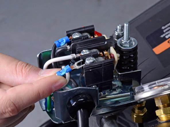

  5. MiTM Air Compressors AM1HE0205HD 2014 Pressure Switch Replacement, Disconnect the power cord: crwdns2935265:05crwdnd2935265:01crwdnd2935265:02crwdne2935265:0 MiTM Air Compressors AM1HE0205HD 2014 Pressure Switch Replacement, Disconnect the power cord: crwdns2935265:05crwdnd2935265:02crwdnd2935265:02crwdne2935265:0
    • Use a Phillips driver to loosen the three screws securing the power cord wires.
  6. MiTM Air Compressors AM1HE0205HD 2014 Pressure Switch Replacement: crwdns2935265:06crwdnd2935265:01crwdnd2935265:02crwdne2935265:0 MiTM Air Compressors AM1HE0205HD 2014 Pressure Switch Replacement: crwdns2935265:06crwdnd2935265:02crwdnd2935265:02crwdne2935265:0
    • Slide the white power wire's spade terminal connector straight out from under its screw.
  7. MiTM Air Compressors AM1HE0205HD 2014 Pressure Switch Replacement: crwdns2935265:07crwdnd2935265:01crwdnd2935265:02crwdne2935265:0 MiTM Air Compressors AM1HE0205HD 2014 Pressure Switch Replacement: crwdns2935265:07crwdnd2935265:02crwdnd2935265:02crwdne2935265:0
    • Slide the black power wire's spade terminal connector straight out from under its screw.
    • Slide the green ground wire's spade terminal connector straight out from under its screw.

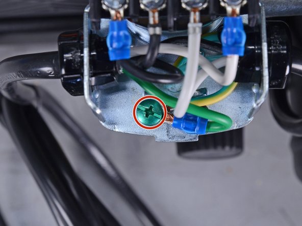

  10. MiTM Air Compressors AM1HE0205HD 2014 Pressure Switch Replacement, Disconnect the secondary power cord: crwdns2935265:010crwdnd2935265:01crwdnd2935265:01crwdne2935265:0
    • Use a Phillips driver to loosen the two remaining screws securing secondary power cord wires in the pressure switch.
  11. MiTM Air Compressors AM1HE0205HD 2014 Pressure Switch Replacement: crwdns2935265:011crwdnd2935265:01crwdnd2935265:03crwdne2935265:0 MiTM Air Compressors AM1HE0205HD 2014 Pressure Switch Replacement: crwdns2935265:011crwdnd2935265:02crwdnd2935265:03crwdne2935265:0 MiTM Air Compressors AM1HE0205HD 2014 Pressure Switch Replacement: crwdns2935265:011crwdnd2935265:03crwdnd2935265:03crwdne2935265:0
    • Slide the three secondary power cord wires out from under their respective screws.

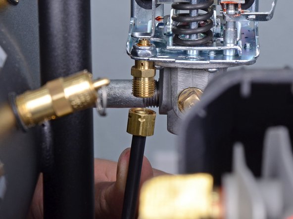

  14. MiTM Air Compressors AM1HE0205HD 2014 Pressure Switch Replacement, Remove the air hose: crwdns2935265:014crwdnd2935265:01crwdnd2935265:02crwdne2935265:0 MiTM Air Compressors AM1HE0205HD 2014 Pressure Switch Replacement, Remove the air hose: crwdns2935265:014crwdnd2935265:02crwdnd2935265:02crwdne2935265:0
    • Use a 1/2 inch wrench to loosen and remove the air hose from the bottom of the pressure switch.
