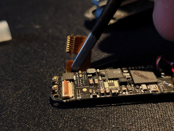

  3. Mi Band 3 Teardown, Removing the mainboard: crwdns2935265:03crwdnd2935265:01crwdnd2935265:03crwdne2935265:0 Mi Band 3 Teardown, Removing the mainboard: crwdns2935265:03crwdnd2935265:02crwdnd2935265:03crwdne2935265:0 Mi Band 3 Teardown, Removing the mainboard: crwdns2935265:03crwdnd2935265:03crwdnd2935265:03crwdne2935265:0
    • Unscrew two Philips PH00 screws at the bottom and use the spudger to lift it up.
    • Next remove the mainboard with the battery. Battery isn't glued to the chassis so it's easy to lift up.

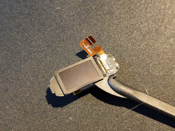

  4. Mi Band 3 Teardown, Removing the OLED screen: crwdns2935265:04crwdnd2935265:01crwdnd2935265:03crwdne2935265:0 Mi Band 3 Teardown, Removing the OLED screen: crwdns2935265:04crwdnd2935265:02crwdnd2935265:03crwdne2935265:0 Mi Band 3 Teardown, Removing the OLED screen: crwdns2935265:04crwdnd2935265:03crwdnd2935265:03crwdne2935265:0
    • Use spudger to lift the orange clip at the bottom and take out the ribbon with tweezers.
    • Next to pty up the screen use the haliberd spudger to cut trough the adhesive under the OLED.
