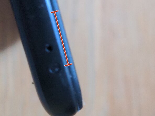

  2. Mi A2 Lite Battery Replacement, Unclip the back cover: crwdns2935265:02crwdnd2935265:01crwdnd2935265:03crwdne2935265:0 Mi A2 Lite Battery Replacement, Unclip the back cover: crwdns2935265:02crwdnd2935265:02crwdnd2935265:03crwdne2935265:0 Mi A2 Lite Battery Replacement, Unclip the back cover: crwdns2935265:02crwdnd2935265:03crwdnd2935265:03crwdne2935265:0
    • During this step, make sure you only pry in the seam around the plastic frame, and not between the frame and the glass. The red area shown in the photo is where you should pry.
    • Start by inserting a plastic pick into the area above the SIM card tray. Then slide it down the long edge of the phone - you should see the plastic start to separate if you do it right.
    • Continue prying all the way around the phone, until the back cover is free to come off. (Don't remove it yet, there is still a ribbon cable!)
