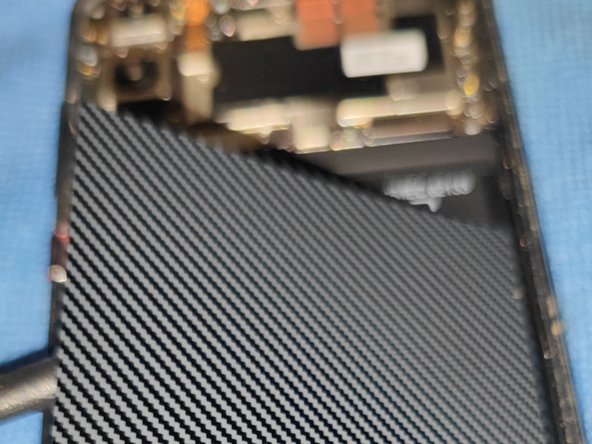

    • As per usual, heat the glue to soften it, and use picks to cut.
    • I found that it was pretty easy to get in there by using a suction cup with a small amount of pressure along with a Halberd spudger to get it started.

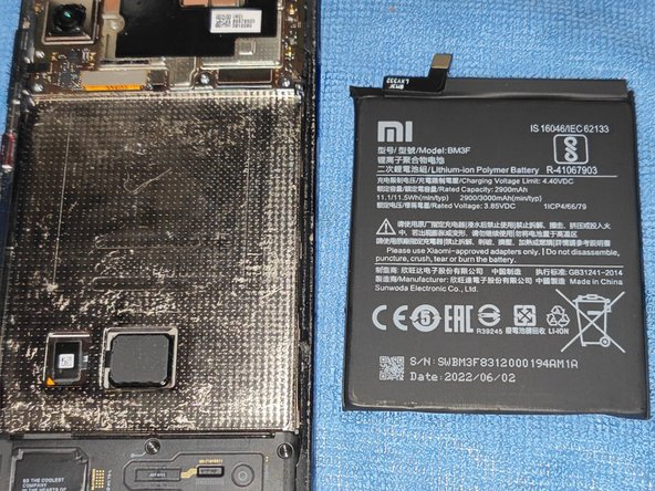

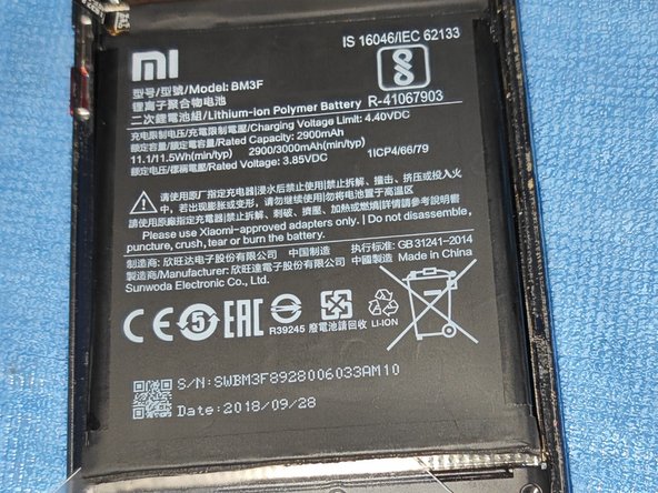

    • Unclip the battery connector and remove the sticker over the battery, to see the battery in all its glory!
  4. Mi 8 Explorer Battery Replacement: crwdns2935265:04crwdnd2935265:01crwdnd2935265:02crwdne2935265:0 Mi 8 Explorer Battery Replacement: crwdns2935265:04crwdnd2935265:02crwdnd2935265:02crwdne2935265:0
    Plastic Cards
    $2.99
    • Remove the battery, unlike the Original Mi 8 Pro, I didn't find any glue tabs to remove the battery, so I used a mix of my Halberd Spudger, and a plastic card to remove the battery.
    • Insert the replacement battery, and test the phone.
Once ready, follow steps backwards as normal!
