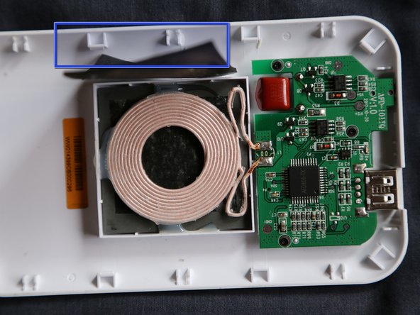

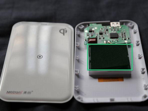

  2. Metrans MWT01 Qi Wireless Charger Teardown: crwdns2935265:02crwdnd2935265:01crwdnd2935265:02crwdne2935265:0 Metrans MWT01 Qi Wireless Charger Teardown: crwdns2935265:02crwdnd2935265:02crwdnd2935265:02crwdne2935265:0
    • Top and bottom shells are separated by 10 plastic clips.
    • To open, insert plastic opening tool or plastic knife and push inward and towards the top shell.
    • Start from near the USB port and work your way around. The corners are pretty hard and the clips are pretty sturdy.
    • Viola! Its open!
    • Holes there are for ventilation for the coil

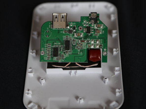

  3. Metrans MWT01 Qi Wireless Charger Teardown: crwdns2935265:03crwdnd2935265:01crwdnd2935265:03crwdne2935265:0 Metrans MWT01 Qi Wireless Charger Teardown: crwdns2935265:03crwdnd2935265:02crwdnd2935265:03crwdne2935265:0 Metrans MWT01 Qi Wireless Charger Teardown: crwdns2935265:03crwdnd2935265:03crwdnd2935265:03crwdne2935265:0
    • More pictures.
    • Coil is covered by a foam pad held down by a little glue.
