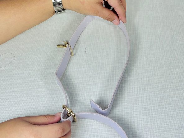

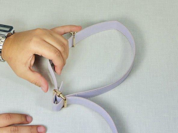

      • Locate the broken metal clasp.

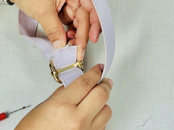

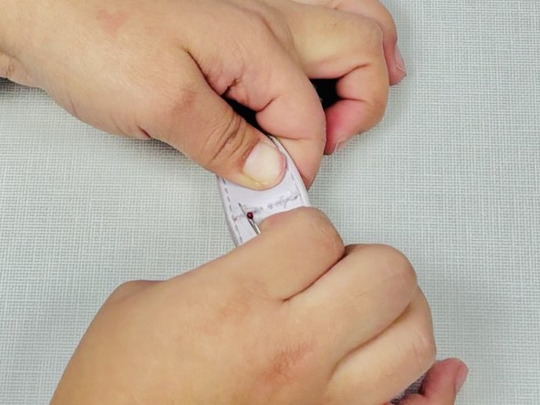

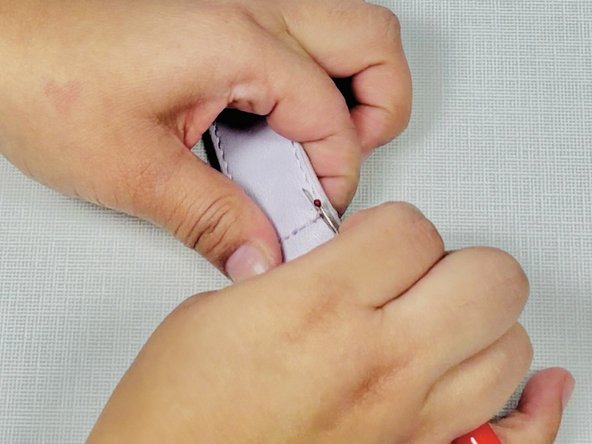

      • Rip the thread using a seam ripper by cutting in a perpendicular direction.
    4. Metal Backpack Clasp Replacement: crwdns2935265:04crwdnd2935265:01crwdnd2935265:03crwdne2935265:0 Metal Backpack Clasp Replacement: crwdns2935265:04crwdnd2935265:02crwdnd2935265:03crwdne2935265:0 Metal Backpack Clasp Replacement: crwdns2935265:04crwdnd2935265:03crwdnd2935265:03crwdne2935265:0

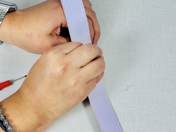

      • Pull out all of the loose thread.

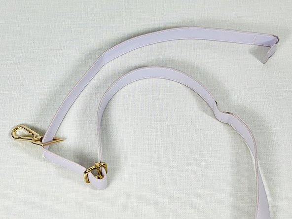

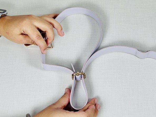

      • Pull out the strap through the buckle.

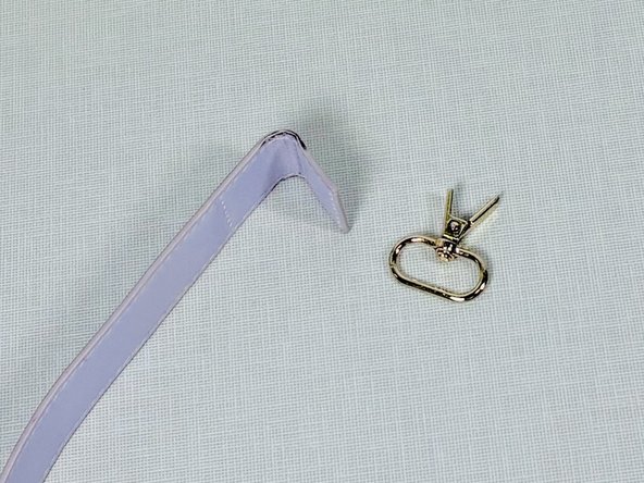

      • Remove the broken metal clasp.
    7. Metal Backpack Clasp Replacement: crwdns2935265:07crwdnd2935265:01crwdnd2935265:02crwdne2935265:0 Metal Backpack Clasp Replacement: crwdns2935265:07crwdnd2935265:02crwdnd2935265:02crwdne2935265:0
      • Hoop in the new metal clasp where the broken clasp was located.

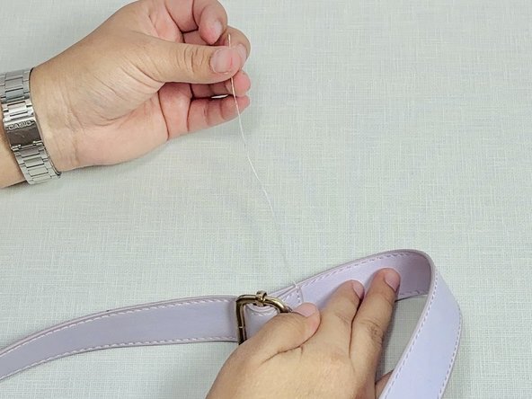

      • Mishandling of the needle could result in minor or moderate injury.

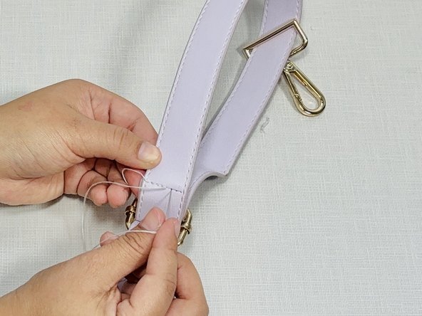

      • Re-stitch the strap using a needle and thread following the holes of the original stitch.

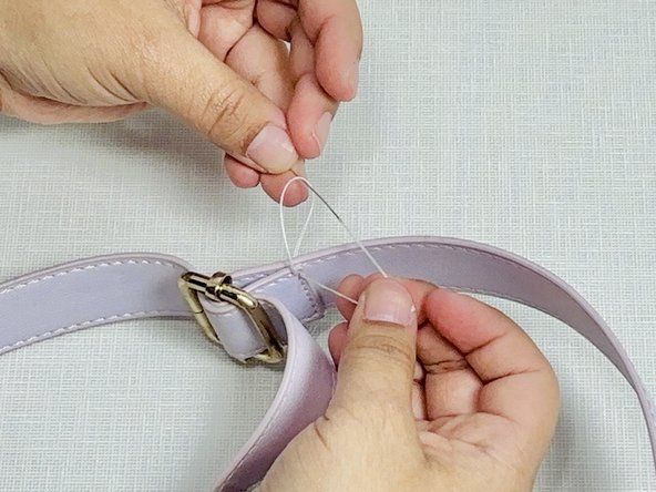

      • Tie a secure knot at the end of the stitch.
