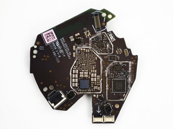

  1. Meta Quest Pro Chip ID, Headset Mainboard Side A: crwdns2935265:01crwdnd2935265:01crwdnd2935265:01crwdne2935265:0
  2. Meta Quest Pro Chip ID: crwdns2935265:02crwdnd2935265:01crwdnd2935265:01crwdne2935265:0
    • Infineon CYPD3177 USB Type-C Port Controller
    • Qualcomm SMB1355 Li-Ion Battery Charger w/ Quick Charge 2.0/3.0/5.0
    • Qualcomm PM3003A Power Management
    • Texas Instruments TLC59401 16-Ch. LED Driver
    • Texas Instruments TS3USB221 USB 2.0 SPDT Analog Switch
    • Awinic AW37504CSR ? Dual Output Power Supply
    • Analog Devices MAX77827B 1.6 A Buck Boost Converter
