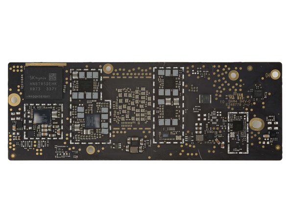

  3. Meta Quest 3S Chip ID, Main Board Side 2: crwdns2935265:03crwdnd2935265:01crwdnd2935265:02crwdne2935265:0 Meta Quest 3S Chip ID, Main Board Side 2: crwdns2935265:03crwdnd2935265:02crwdnd2935265:02crwdne2935265:0
    • SK hynix HN8T05DEHKX073 128 GB NAND flash memory
    • Qualcomm PMXR2230-001 power management
    • Qualcomm PMXR2230B-002 power management
    • Qualcomm PMXR2230VE-001 power management
    • Qualcomm PMXR2230VS-001 power management
    • Analog Devices MAX98388 mono class-D audio amplifier
    • Qualcomm clock generator
