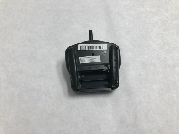

    • Turn the remote controller over to the back.
  2. MerchSource the Black Series Boat Racer Battery Cable Replacement: crwdns2935265:02crwdnd2935265:01crwdnd2935265:01crwdne2935265:0
    • Slide the battery cover off.
  3. MerchSource the Black Series Boat Racer Battery Cable Replacement: crwdns2935265:03crwdnd2935265:01crwdnd2935265:02crwdne2935265:0 MerchSource the Black Series Boat Racer Battery Cable Replacement: crwdns2935265:03crwdnd2935265:02crwdnd2935265:02crwdne2935265:0
    • Remove both AA-batteries.
  4. MerchSource the Black Series Boat Racer Battery Cable Replacement: crwdns2935265:04crwdnd2935265:01crwdnd2935265:01crwdne2935265:0
    • Use a Phillips #1 screwdriver, remove the four screws located in the four corners of the back of the remote controller.
    • Screw length is 6 mm.

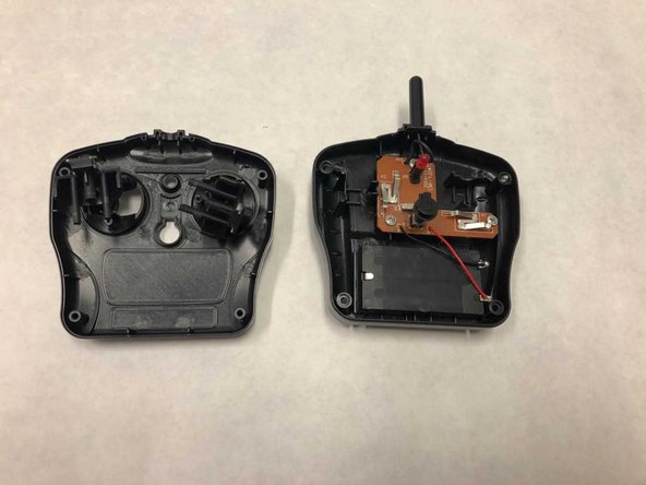

  5. MerchSource the Black Series Boat Racer Battery Cable Replacement: crwdns2935265:05crwdnd2935265:01crwdnd2935265:03crwdne2935265:0 MerchSource the Black Series Boat Racer Battery Cable Replacement: crwdns2935265:05crwdnd2935265:02crwdnd2935265:03crwdne2935265:0 MerchSource the Black Series Boat Racer Battery Cable Replacement: crwdns2935265:05crwdnd2935265:03crwdnd2935265:03crwdne2935265:0
    • Separate the two halves of the remote controller.
  6. MerchSource the Black Series Boat Racer Battery Cable Replacement: crwdns2935265:06crwdnd2935265:01crwdnd2935265:01crwdne2935265:0
    • Solder the wire to reconnect it.
