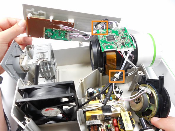

  4. Merch Source Projector Entertainment II Speaker Replacement, Speaker: crwdns2935265:04crwdnd2935265:01crwdnd2935265:02crwdne2935265:0 Merch Source Projector Entertainment II Speaker Replacement, Speaker: crwdns2935265:04crwdnd2935265:02crwdnd2935265:02crwdne2935265:0
    • Locate the 2 screws on the handle casing. These screws are mirrored on the handle attachment on the other side panel as well.
    • Unscrew the two 16mm screws using the Phillips #0 screw driver. Repeat for the opposite side panel.
    • You do not need to remove the motherboard to reach the screws next to the lens. This is only done to show the screws more clearly.

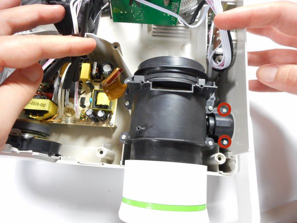

  5. Merch Source Projector Entertainment II Speaker Replacement: crwdns2935265:05crwdnd2935265:01crwdnd2935265:02crwdne2935265:0 Merch Source Projector Entertainment II Speaker Replacement: crwdns2935265:05crwdnd2935265:02crwdnd2935265:02crwdne2935265:0
    • Lift up on the side panel and speaker attachment to slightly dislodge it.
    • Unscrew the four 9mm Phillips screws with a Phillips #0 screw driver, located on the outside of the projector casing.

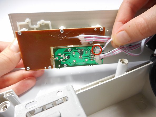

  8. Merch Source Projector Entertainment II Speaker Replacement: crwdns2935265:08crwdnd2935265:01crwdnd2935265:03crwdne2935265:0 Merch Source Projector Entertainment II Speaker Replacement: crwdns2935265:08crwdnd2935265:02crwdnd2935265:03crwdne2935265:0 Merch Source Projector Entertainment II Speaker Replacement: crwdns2935265:08crwdnd2935265:03crwdnd2935265:03crwdne2935265:0
    • Locate the two speaker wires connected to the sound and audio motherboard on the left panel opposite of the speaker. Unsolder these connections with a soldering iron.
    • Once the wires are disconnected, in order to fully remove the speaker you may need to cut the plastic bands holding the speaker wires in place.
    • Need some help? Follow this guide to learn soldering basics.
    • To get to the connections on the motherboard, you will need to peel off the hot glue covering them.
    • While unsoldering, the metal connections can get very hot. Never touch the iron with your hand. Also, make sure that the projector is fully turned off and not plugged in.
