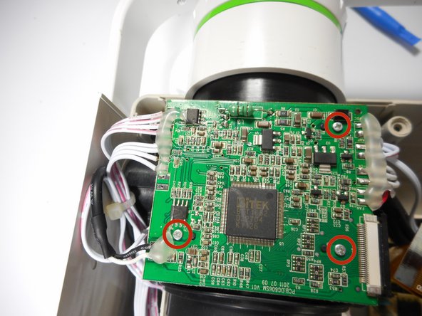

  5. Merch Source Projector Entertainment II Outer Lens Replacement, Motherboard Detachment: crwdns2935265:05crwdnd2935265:01crwdnd2935265:03crwdne2935265:0 Merch Source Projector Entertainment II Outer Lens Replacement, Motherboard Detachment: crwdns2935265:05crwdnd2935265:02crwdnd2935265:03crwdne2935265:0 Merch Source Projector Entertainment II Outer Lens Replacement, Motherboard Detachment: crwdns2935265:05crwdnd2935265:03crwdnd2935265:03crwdne2935265:0
    • Unscrew the three 7 mm screws from the motherboard with the Phillips #0 screw driver.
    • Once loose, lift the motherboard off of the lens casing, and move it away from the workspace.
    • Be sure not to damage any of the wires atached to the motherboard.

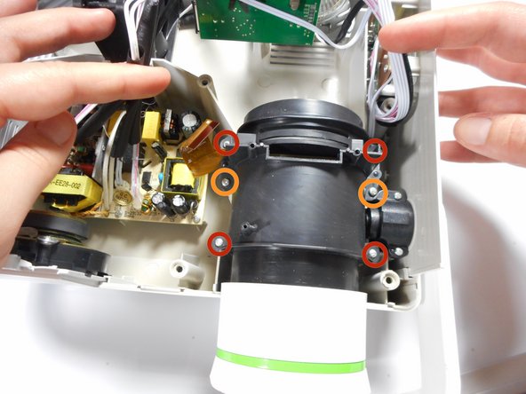

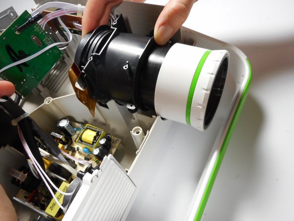

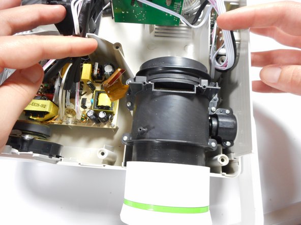

  6. Merch Source Projector Entertainment II Outer Lens Replacement, Lens Casing Detachment: crwdns2935265:06crwdnd2935265:01crwdnd2935265:03crwdne2935265:0 Merch Source Projector Entertainment II Outer Lens Replacement, Lens Casing Detachment: crwdns2935265:06crwdnd2935265:02crwdnd2935265:03crwdne2935265:0 Merch Source Projector Entertainment II Outer Lens Replacement, Lens Casing Detachment: crwdns2935265:06crwdnd2935265:03crwdnd2935265:03crwdne2935265:0
    • Unscrew the four 15mm Phillips screws using the Phillips #0 screw driver.
    • Unscrew the two 12mm Phillips screws using the Phillips #0 screw driver.
    • Gently remove the entire lens casing from its position.

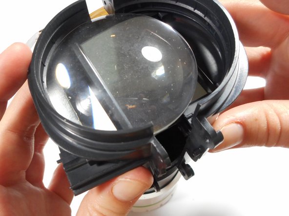

  7. Merch Source Projector Entertainment II Outer Lens Replacement, Lens Casing Seperation: crwdns2935265:07crwdnd2935265:01crwdnd2935265:03crwdne2935265:0 Merch Source Projector Entertainment II Outer Lens Replacement, Lens Casing Seperation: crwdns2935265:07crwdnd2935265:02crwdnd2935265:03crwdne2935265:0 Merch Source Projector Entertainment II Outer Lens Replacement, Lens Casing Seperation: crwdns2935265:07crwdnd2935265:03crwdnd2935265:03crwdne2935265:0
    • Using the plastic opening tool, slightly separate the casing holding the large lens in place.
    • Separate the casing completely from the inner lens using your hands.
    • This should release the outer lens and it's immediate casing.
    • As you separate the outer casing, the lens and digital display box may fall out of their encasement.
    • Although there are threads connecting the outer lens casing and the inner lens casing, do not be fooled. The outer lens casing cannot be disconnected by unscrewing it.

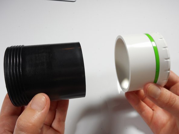

  8. Merch Source Projector Entertainment II Outer Lens Replacement, Outer Lens Casing Seperation: crwdns2935265:08crwdnd2935265:01crwdnd2935265:03crwdne2935265:0 Merch Source Projector Entertainment II Outer Lens Replacement, Outer Lens Casing Seperation: crwdns2935265:08crwdnd2935265:02crwdnd2935265:03crwdne2935265:0 Merch Source Projector Entertainment II Outer Lens Replacement, Outer Lens Casing Seperation: crwdns2935265:08crwdnd2935265:03crwdnd2935265:03crwdne2935265:0
    • Unscrew the four 8mm Phillips screws at the base of the outer lens casing using the Phillips #0 screw driver.
    • Separate the white outer casing from the black outer casing.

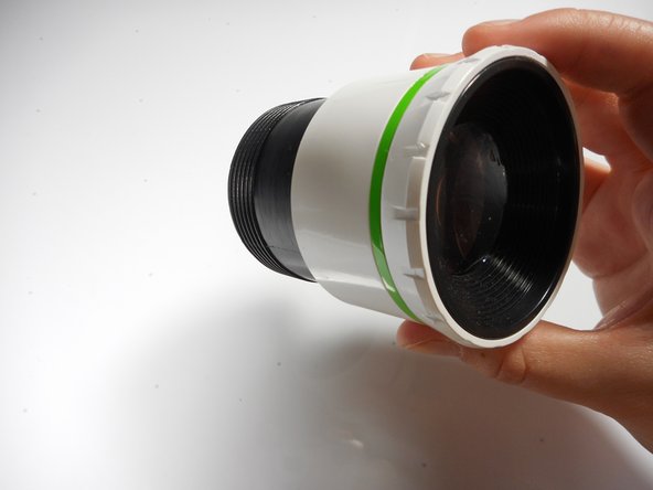

  9. Merch Source Projector Entertainment II Outer Lens Replacement, Final Outer Lens Removal: crwdns2935265:09crwdnd2935265:01crwdnd2935265:02crwdne2935265:0 Merch Source Projector Entertainment II Outer Lens Replacement, Final Outer Lens Removal: crwdns2935265:09crwdnd2935265:02crwdnd2935265:02crwdne2935265:0
    • Using your finger, gently push the lens out of its white encasement.
    • The outer lens is now free and ready for replacement.
