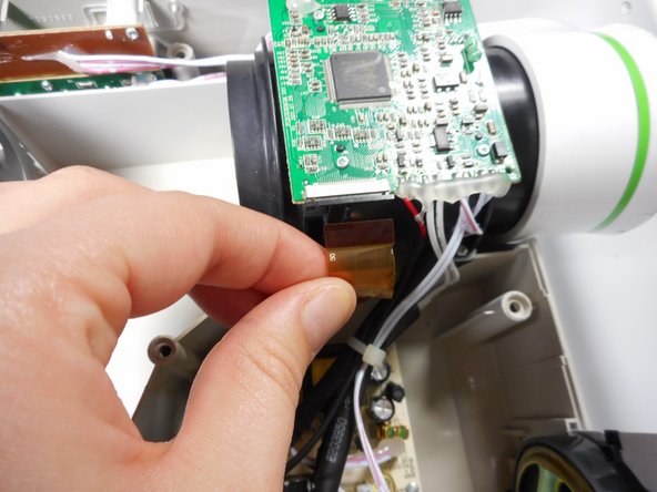

    • Use the plastic opening tool to gently disengage the ribbon cable from its back housing.
    • Once the ribbon cable is disengaged gently pull the cable off the motherboard.
    • Once the housing is disengaged, the ribbon cable should slide out easy. Do not pull too hard on the ribbon cable as it is very fragile.

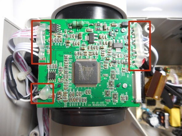

  5. Merch Source Projector Entertainment II Motherboard: crwdns2935265:05crwdnd2935265:01crwdnd2935265:02crwdne2935265:0 Merch Source Projector Entertainment II Motherboard: crwdns2935265:05crwdnd2935265:02crwdnd2935265:02crwdne2935265:0
    • Unscrew the three 6 mm screws from the motherboard with the Phillips #0 screwdriver.
    • Be sure not to damage any of the wires atached to the motherboard.
  6. Merch Source Projector Entertainment II Motherboard: crwdns2935265:06crwdnd2935265:01crwdnd2935265:02crwdne2935265:0 Merch Source Projector Entertainment II Motherboard: crwdns2935265:06crwdnd2935265:02crwdnd2935265:02crwdne2935265:0
    • Solder off all of the connections on the motherboard with a soldering iron.
    • Once connections are soldered off, the motherboard should be detached and ready for replacement.
    • Need some help? Follow this guide to learn soldering basics.
    • While soldering the metal connections can get very hot. Never touch the iron with your hand. also make sure that the projector is fully turned off and not plugged in.
    • If there is hot glue on top on the connection with the motherboard, you will need to peel it off using your fingers.
