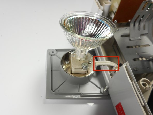

  4. Merch Source Projector Entertainment II Light Bulb Replacement, Remove light bulb assembly from housing unit: crwdns2935265:04crwdnd2935265:01crwdnd2935265:03crwdne2935265:0 Merch Source Projector Entertainment II Light Bulb Replacement, Remove light bulb assembly from housing unit: crwdns2935265:04crwdnd2935265:02crwdnd2935265:03crwdne2935265:0 Merch Source Projector Entertainment II Light Bulb Replacement, Remove light bulb assembly from housing unit: crwdns2935265:04crwdnd2935265:03crwdnd2935265:03crwdne2935265:0
    • Remove the light bulb from its housing unit.
    • Do not damage the 2 white cables leading into the light bulb panel.

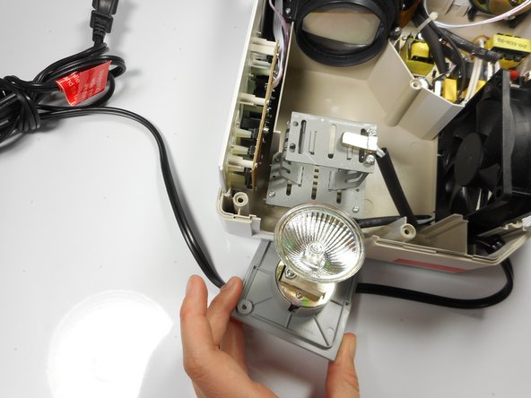

  5. Merch Source Projector Entertainment II Light Bulb Replacement, Replace light bulb: crwdns2935265:05crwdnd2935265:01crwdnd2935265:02crwdne2935265:0 Merch Source Projector Entertainment II Light Bulb Replacement, Replace light bulb: crwdns2935265:05crwdnd2935265:02crwdnd2935265:02crwdne2935265:0
    • Remove the light bulb from the door panel by gently wiggling it back and forth. Do not twist the light bulb.
    • The light blub is held into the socket with prongs, and should easily pull straight out.
